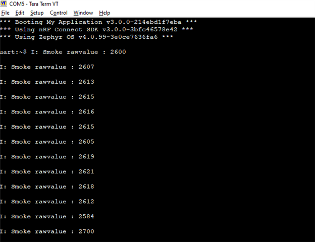

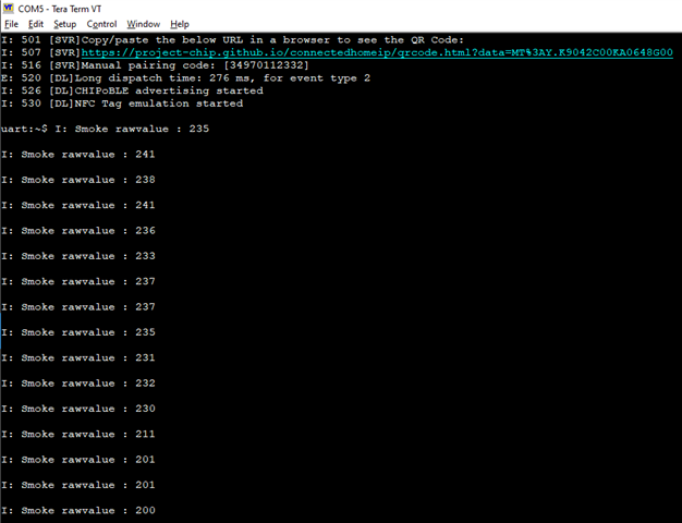

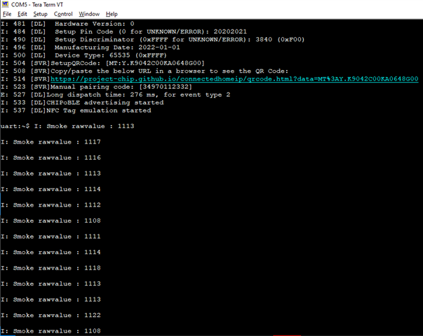

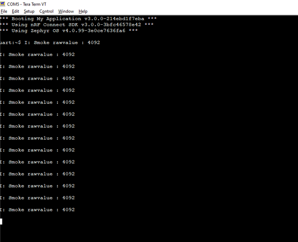

Based on the two code snippets above, we examined the ADC raw data values under the following scenarios:
A) Without initializing the Matter stack, the value is read within the while(1) loop in main.cpp.
B) Initializing the Matter stack, the value is read using a timer.
  • Scenario A-1 readings:
  • Scenario B-1 readings:
  • Scenario A-2 readings:
  • Scenario B-2 readings:
    In the above, we observe readings from two scenarios, where A/B refer to the test conditions (as described earlier), and 1/2 refer to the corresponding reading numbers.
    Scenario A-1: With the potentiometer set to a specific value, the ADC reading was approximately 1111.
    Scenario B-1: Using the same potentiometer setting, the ADC reading was 4092.
    Scenario A-2: At a different potentiometer setting, the ADC reading was approximately 241.
    Scenario B-2: With the same setting, the ADC reading was around 2600.
    We can see a significant difference in the readings between the two scenarios.
    We would like to understand why the readings appear incorrect when the Matter stack is initialized.
    Looking forward to your insights.
