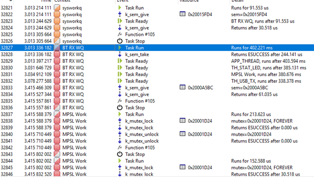

I'm working on a project involving a USB dongle based on the nRF52840 SDK-2.9.1, which needs to communicate with a sensor (also an nRF52840) and transmit data via USB to PC software. Everything seemed to work fine at first, but I noticed that sometimes the communication freezes.

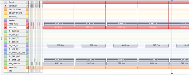

Initially, I thought the issue was on the sensor side, but I later discovered that the problem lies within the USB dongle. When the data transmission gets stuck, the device starts running in "slow motion"—I can tell because the LED fade effect becomes so slow that it looks frozen (but it's not actually stuck).
At this point, I configured the project to use Segger SystemView, and after several attempts (SystemView often freezes), I finally managed to capture the moment when the issue occurs. Apparently, there's a thread I didn’t create that runs for about 400 milliseconds without yielding, effectively blocking the others. The thread is named BT_RX_WQ and seems to belong to the Bluetooth stack.
Can anyone help me?
Here is the SystemView trace images and my current configuration.

  • Hello! I am sorry for the late reply. I was assigned your ticket, but then I have been out of office for a few days.
    What is the TH_STAT_LED on line 32830 from your log?
    Do any of your work handlers have any delays (k_sleep()) or something? If so, I advice you to do the sleeping outside your work handlers, or they may block eachother.
    Is it possible for me to reproduce what you are seeing? Is it possible to upload your application?
    Edvin
