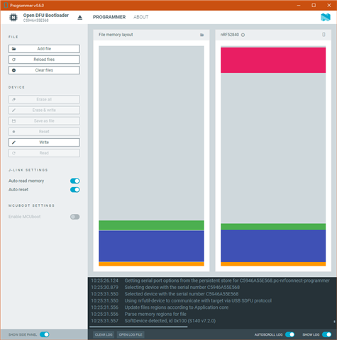

I have used the Programmer previously with success. I am attempting to program the Dongle (10059) with a slightly modified version of ble_nusc_usb_dongle. Although it claims to have completed successfully in 14 seconds, it halts with an error message in red in the log. Also I note that the memory map shown in the Programmer does not change.

  • I have what is apparently the same file from 17.0.2. It loads correctly, no error messages, and the memory map of the target is correctly updated. For whatever reason, my target hex file still generates the same error when I attempt to program. Here's a screenshot after an unsuccessful load, just prior to attempting to program again. Note that the Application area has only partially loaded, and the bootloader area does not appear to be exactly the same size either. Thus I deduce that the programming failed partway thru, but it did overwrite what was loaded previously from the file you suggested.

  • It's not possible to boot a partially updated application. In other words, if the app is now using a different manufacturer and product string, it means the update was successfully completed. Does it work again if you revert your modifications of the FW?
    The programmer app is only able to read back the memory content when you have a debugger attached, not when using SDFU. Thus, the representation shown in the UI may not be correct.
