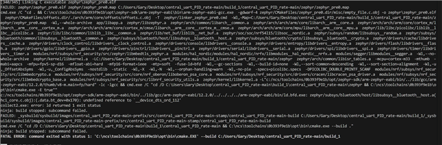

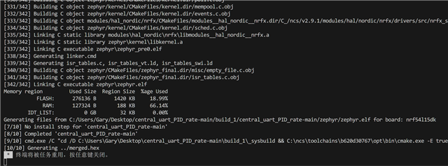

I have a code previously can be built in NCS 2.91:
However, when I use the new NCS 3.01, it can not be built, the error is:
Could you please help me figure out the problems?

There can be some changes between these major NCS versions. I would recommend having a look at the changelog.
undefined reference to `__device_dts_ord_112' typically means that there is something lacking in the dts file. What is new in DTS in NCS 3 is among other things that
It is hard immediately to say exactly what is at fault though.
Elfving
THank you so much! I just realized I should delete
