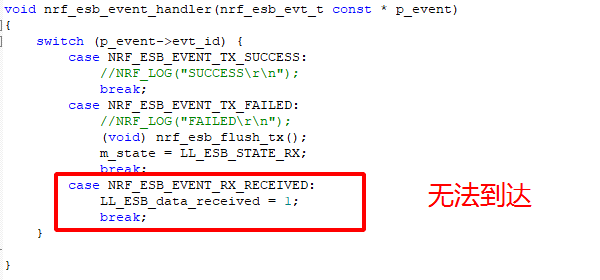

When I was conducting the integration test between my device (nRF52832) and the external device (nRF24L), I encountered a problem.
The nRF24L sent a message via 2.4GHz. The nRF52832 was able to enter the function "static void on_radio_disabled_rx(void)", and from the code in this function, m_rx_payload_buffer showed the correct data content, but the length seemed incorrect (this has not been confirmed yet). However, it was still unable to reach the top-level interrupt function of ESB, nrf_esb_event_handler(). Could you please tell me if there is something wrong with this situation?
It should be noted that I used the esb_ptx in the SDK17.1 to send the message via 52832 development board or prodcuts(52810/52832) by ourself, and my NRF52832 transceiver was functioning properly.

    There is too little information to be able to diagnose the problem. When you wrote that nRF24L is sending the data, are you sure that the payload size of PTX in your nRF24L configuration matches the PRX size in your nRF52832 receive end?
    Can you please show some code snippets on both the PTX and PRX sideon how you configure nrf_esb_config_t  structure.
    I also think that it is best to read the full buffer in your nrf_esb_event_handler(nrf_esb_evt_t const * p_event) function and process the packet before you read another packet.

    Since the nRF24l is a device from an external company, I can only provide their configuration.
    nRF24L
    1)Reg(0x20+0x10),write buffer{0XA1,0XA2,0XA3,0XA4,0XA5},byte5;
    2)Reg(0x20+0x0A),write buffer{0XA1,0XA2,0XA3,0XA4,0XA5},byte5;
    3)Reg(0X20+0X01),write 0X01; //enable ack
    4)Reg(0X20+0X02),write 0X01; //enable rev address
    5)Reg(0X20+0X04),write 0X01; //auto ack
    6)Reg(0X20+0X05),write 58;   //RF CHANNEL
    7)Reg(0X20+0X11),write 16;   //data length
    9)Reg(0X20+0X00),write 0X0E;//CONFIG
    This is nRF52832 config

  • I would suggest not to use the DPL and used fixed length
    // change below
    nrf_esb_config.protocol       = NRF_ESB_PROTOCOL_ESB_DPL;
    to
    // fixed, 16-byte packets
    nrf_esb_config.protocol       = NRF_ESB_PROTOCOL_ESB;
    nrf_esb_config.payload_length = 16;
    Also your CRC should match. Make sure that your PRX is also have 16bit CRC as the 16 bit CRC you have configured here for PTX.

    I do not see any other things apart from this checks on PRX matching your PTX configuration.
