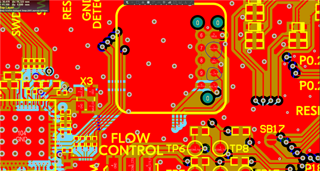

Parents Reply
    I see..
    Do you have a stand alone debugger? I haven't tried, but it might be possible with another devkit as well.
    Can you try to flash the interface chip manually by connecting to its SWD interface? It should be under the sticker on the board:
    You need a 10 pin J-tag connector.
    Repeat the nrfutil command with the debugger connected to the SWD interface on the board.
    best regards
