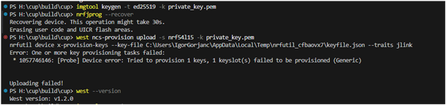

I get error provisioning key on nRF54L15 and NCS 3.0.1. I tried using "Erase all" in nRF connect SDK Programmer, but it doesn't help. Please check also the attached log.
nrf54l15dk/nrf54l15/cpuapp/ns is used.
PS H:\cup> python H:/ncs/v3.0.1/bootloader/mcuboot/scripts/imgtool.py keygen -t ed25519 -k private_key.pem
PS H:\cup> west ncs-provision upload -s nrf54l15 -k private_key.pem
nrfutil device x-provision-keys --key-file [redacted]\Temp\nrfutil_j8mc7y15\keyfile.json --traits jlink
Error: One or more key provisioning tasks failed:
 * 1057746146: [Probe] Device error: Tried to provision 1 keys, 1 keyslot(s) failed to be provisioned (Generic)
Uploading failed!
PS H:\cup> nrfutil device x-provision-keys --key-file [redacted]\Temp\nrfutil_j8mc7y15\keyfile.json --traits jlink --log-level trace --log-output stdout --json > log.txt

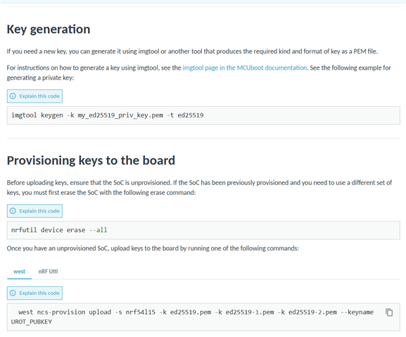

    Looks like you're missing a command in https://docs.nordicsemi.com/bundle/ncs-latest/page/nrf/app_dev/device_guides/nrf54l/kmu_provision.html, i.e the erase command in between generating the key and uploading the key
    Let me know if this changes anything.
    Andreas
  • Erase does not help.
    PS H:\cup> python H:\ncs\v3.0.1\bootloader/mcuboot/scripts/imgtool.py keygen -t ed25519 -k private_key.pem
    PS H:\cup> nrfutil device erase --all
    v Erased 1057746146
    nrfutil device x-provision-keys --key-file [redacted]\Temp\nrfutil_2twnst4d\keyfile.json --traits jlink
    Uploading failed!

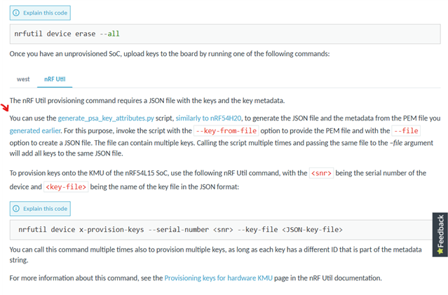

  • Fair enough, you also mentioned that you used the erase in VS Code as well.
    Could you go through the steps you used to generate the JSON-key-file in the last step "nrfutil device x-provision-keys --serial-number <snr> --key-file <JSON-key-file>" just so we have the same foundation for recreating if the docs works or not?
    Andreas
  • I still get the same error.
    v Erased 1057746146
    PS H:\cup> openssl genpkey -algorithm Ed25519 -out private_key.pem
    PS H:\cup> openssl pkey -in private_key.pem -pubout -out public_key.pem
    PS H:\cup> python H:\ncs\v3.0.1\nrf\scripts\generate_psa_key_attributes.py --usage VERIFY_MESSAGE_EXPORT --id 0x40022100 --type ECC_TWISTED_EDWARDS --size 255 --algorithm EDDSA_PURE --location LOCATION_CRACEN --key-from-file public_key.pem  --file keys.json --cracen_usage RAW --lifetime PERSISTENCE_DEFAULT
    PS H:\cup> nrfutil device x-provision-keys --serial-number 1057746146 --key-file keys.json
    x Failed to provision keys on 1057746146, [Probe] Device error: Tried to provision 1 keys, 1 keyslot(s) failed to be provisioned

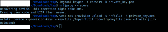

  • Hi again,
    I'm struggling with recreating this from my end i.e it does not fail here.
    I'm sorry to ask you once more, but could you retrace this from the start and following the details in details.
    If it does not work, I suspect there might be an issue with the OS used and I'll file a
    Andreas
