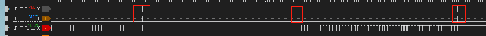

I developed a PWM function to drive the RGB LED. Then I found a problem, which is when I used a PWM signal of one channel to control the RED light of the RGB lamp, causing it to go from bright to off and then back to bright, the other two channels would have a level reversal when the lamp was turned off. This is the data I captured using a logic analyzer.
But in fact, my program doesn't control these two channels. Here is my program and the overlay. This issue causes one of the RGB lights to go out, and the other two channels will flicker for a moment when that happens. Could you please tell me how to turn off the level inversion of the other two channels?

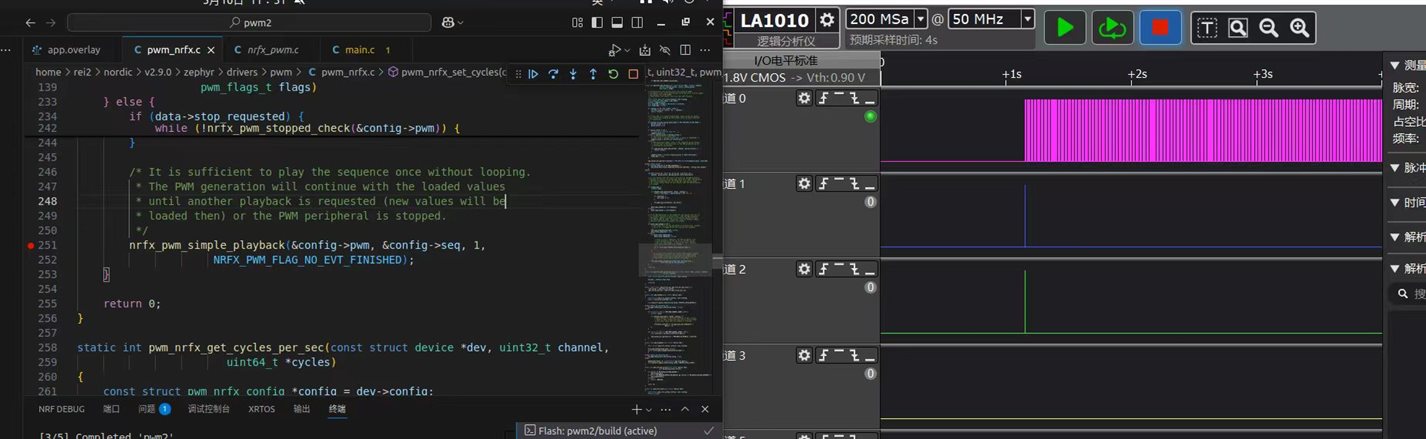

    Today, I debugged and found that only the register configuration of one channel was set. However, the levels of the other two channels were actually flipped. Moreover, this phenomenon does not occur when using three channels; it only happens when using a single channel.

  • Hi Hannibal,
    I reproduced the behavior and trying to debug it now. Will come back to you once I have some progress and new info to share with you.
  • Hi Hannibal,
    I tried to debug this and use a lot of different ways to initialize the PWM and also use pwm_set_pulse_dt individually to set PWM but I can still see the other channels being impacted whenever we start or stop the PWM (brightness level 0->1 or 1->0). I need to spend more time to debug this.
