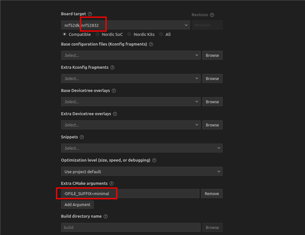

Board: nRF52dk (was not an option when creating ticket)
IDE: vscode, nRF Connect for VS Code Extension Pack
Sample Project: Bluetooth Peripheral UART
Hi there,
I'm having a hard time pairing my phone with the device. When i try to pair with my phone, i get a pop up: "Couldn't connect with NORDIC_UART_SERVICE because of incorrect pin or passkey". After which, LED2 comes on and LED1 stays on instead of doing its blinky (according to the readme, this indicates an active connection).
However, the device is not listed under "Connected Devices" on my phone, and I'm unable to communicate with it via a bluetooth serial terminal.

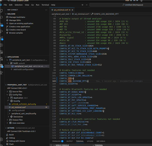

Note that I am using the prj_minimal.conf file as instructed for the nRF52dk, I've set CONFIG_LOG and CONFIG_LOG_BACKEND_RTT to y. Otherwise the sample is as it comes.

    If 52832 is your target and not one of the emulation targets, I recommend you try with the full configuration (prj.conf) instead. I tried building with the minimal configuration and logging enabled, but that led to a stack overflow in one of the threads (stack sizes are optimized in this configuration and not tested with logging)
