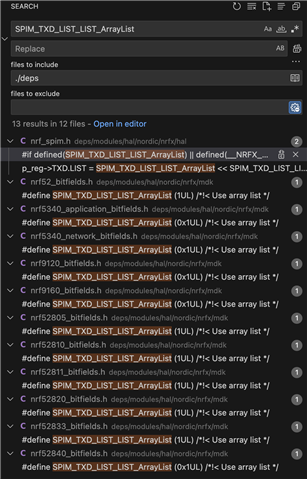

I am currently evaluating the nRF54L15 dk and porting the old project code from the nRF52DK to the new nRF54L15DK devboard. However, I have encountered an issue with attempting to set up the SPI using the NRFX_SPIM_FLAG_TX_POSTINC flag in nrfx_spim_xfer(), which results in a return error code of NRFX_ERROR_NOT_SUPPORTED. It looks like this is due to the option NRFY_SPIM_HAS_ARRAY_LIST being set to 0. Upon further investigation of the SDK code, It looks like the option SPIM_TXD_LIST_LIST_ArrayList is not defined in nrf_spim.h. However, the datasheet for the nRF54L15 clearly indicates that DMA array list is supported for SPIM (The flag also works on the nRF52 dev board). Therefore, I am wondering if I am missing some settings in my project that is specific to this SoC, or perhaps this config was forgotten to set to 1 in the current SDK as the software support for this chip is still sort of in an early stage. Any suggestion or help would be greatly appreciated.
