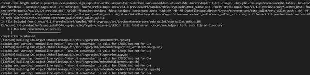

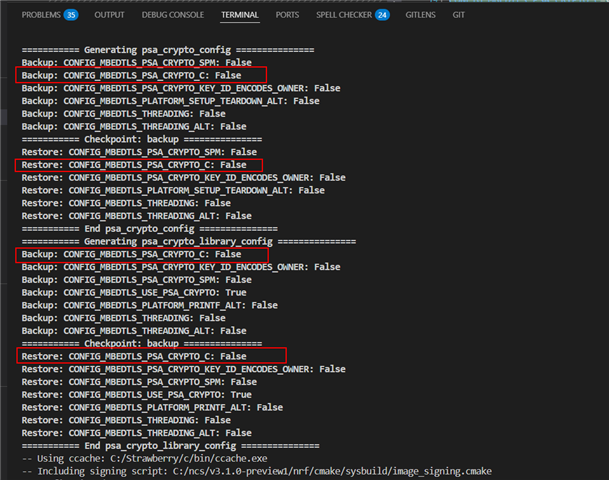

  • Hello Håkon,
    I have another problem when build project with nrf54l15dk_nrf54l15_cpuapp_ns target.
    #1 - I set enable mbedtls, but on the log it always set false.
    CONFIG_MBEDTLS_USE_PSA_CRYPTO=y
    CONFIG_MBEDTLS_PSA_CRYPTO_C=y
    #2 - I want to use low level driver on cracen library to handle my custom cryptography logic such as:
    #include <cracen/mem_helpers.h>
    #include <cracen/statuscodes.h>
    #include <sicrypto/drbghash.h>
    #include <sicrypto/ecdsa.h>
    #include <sicrypto/ed25519.h>
    #include <sicrypto/ik.h>
    #include <sicrypto/internal.h>
    #include <sicrypto/rsapss.h>
    #include <sicrypto/rsassa_pkcs1v15.h>
    #include <sicrypto/sicrypto.h>
    #include <silexpk/blinding.h>
    #include <silexpk/ec_curves.h>
    #include <silexpk/ed25519.h>
    #include <silexpk/ik.h>
    #include <silexpk/sxbuf/sxbufop.h>
    #include <silexpk/sxops/eccweierstrass.h>
    #include <sxsymcrypt/sha1.h>
    #include <sxsymcrypt/sha2.h>
    #include <sxsymcrypt/trng.h>
    I am able to use all this API from when I build with nrf54l15dk_nrf54l15_cpuapp but when I build with nrf54l15dk_nrf54l15_cpuapp_ns, I got no such file or directory during build time.
    Could you please help to check and advise for all this issue?

    It looks like the listing is a visual error? Atleast on my side, the symbols are indeed set.
    I checked for both symbols when building sha256 for nrf54l15dk/nrf54l15/cpuapp/ns:
    $ grep -r -e CONFIG_MBEDTLS_USE_PSA_CRYPTO -e CONFIG_MBEDTLS_PSA_CRYPTO_C
    build/sha256/zephyr/.config:CONFIG_MBEDTLS_PSA_CRYPTO_C=y
    build/sha256/zephyr/.config:CONFIG_MBEDTLS_USE_PSA_CRYPTO=y
    CRACEN is a secure only peripheral:
    https://docs.nordicsemi.com/bundle/ps_nrf54L15/page/cracen.html#ariaid-title21
    and cannot directly be accessed from a non-secure application.
    Any sort of interfacing towards crypto when running secure/non-secure split will have to use a non-secure callable function.
    Håkon
