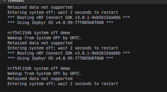

  • The only modification you need to make to the SDK sample is to add CONFIG_GRTC_WAKEUP_ENABLE=y and CONFIG_GPIO_WAKEUP_ENABLE=n to the prj.conf. The reason you are not getting any log messages is that you have enabled logging over RTT instead of UART.

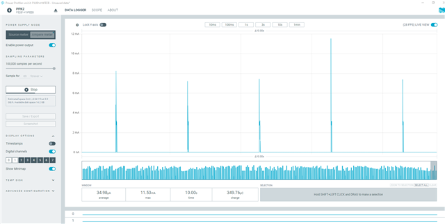

  • Hi.
    With ''nrf54l15dk/nrf54l15/cpuapp', I could see it works normally by using PPK2.
    But, I would like to make it with 'nrf54l15dk/nrf54l15/cpuapp/ns'.
    Why does not this example work ?
    It does not work with then /ns target because the app running in the non-secure processing environment does not have access to the REGULATORS and MEMCONF registers which both are used by sys_poweroff(). Any direct access made to these register from the app will lead to a fault exception.
    I'm not sure how we will expose this functionality to the app yet, but there is an open task internally to address this limitation.
