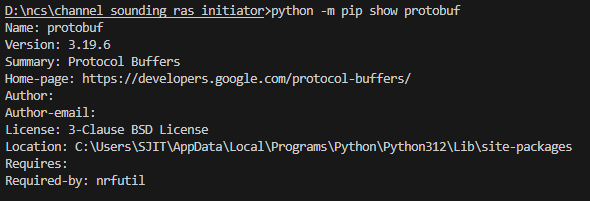

As you can see, we're using protobuf version 3.19.6 as well. (The same error occurred in 3.20.0 version)
But I keep getting protobuf errors, how do I fix it?

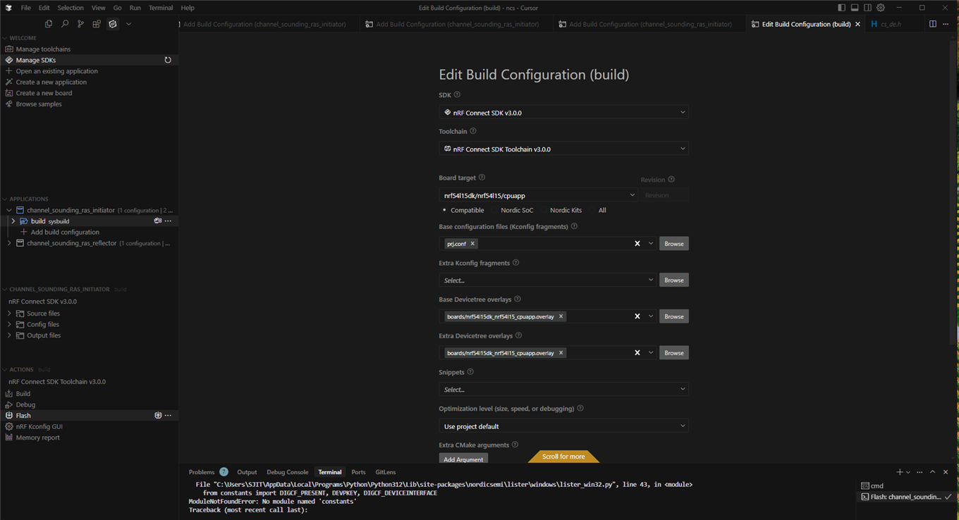

ModuleNotFoundError: No module named 'constants'

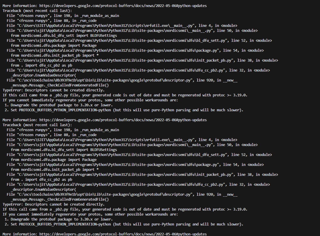

    Initially, I encountered a version-related error with protobuf, so I ran the following command:
    C:\ncs\toolchains\0b393f9e1b\opt\bin\python.exe -m pip install protobuf==3.20.3
    After that, I started getting a 'constants' error.
    I am using SDK v3.0.0, which I downloaded via nRF Connect for Desktop. and I'm using Python 3.12
    I'll be waiting for your reply.

    The reason I mentioned the Python version is because I encountered an error (related to protobuf) during the build and flash process.
    TypeError: Descriptors cannot be created directly.
    If this call came from a _pb2.py file, your generated code is out of date and must be regenerated with protoc >= 3.19.0.
    If you cannot immediately regenerate your protos, some other possible workarounds are:
     1. Downgrade the protobuf package to 3.20.x or lower.
     2. Set PROTOCOL_BUFFERS_PYTHON_IMPLEMENTATION=python (but this will use pure-Python parsing and will be much slower).

    1) Even though I am using both the SDKs and Toolchain version 3.0.0, why am I getting these errors and unable to flash the program?
    (I'm not completely sure, but I think that when I run the flash, it uses the Python installed on my computer instead of the toolchain's Python.
    As you can see, the path follows C:\Users\SJIT\AppData\Local\Programs\Python\Python312\Scripts\nrfutil.exe (my computer path), rather than the toolchain path like C:\ncs\toolchains\....)
    More information: https://developers.google.com/protocol-buffers/docs/news/2022-05-06#python-updates
      File "<frozen runpy>", line 198, in _run_module_as_main
      File "<frozen runpy>", line 88, in _run_code
      File "C:\Users\SJIT\AppData\Local\Programs\Python\Python312\Scripts\nrfutil.exe\__main__.py", line 4, in <module>
      File "C:\Users\SJIT\AppData\Local\Programs\Python\Python312\Lib\site-packages\nordicsemi\__main__.py", line 50, in <module>
        from nordicsemi.dfu.bl_dfu_sett import BLDFUSettings
      File "C:\Users\SJIT\AppData\Local\Programs\Python\Python312\Lib\site-packages\nordicsemi\dfu\bl_dfu_sett.py", line 52, in <module>
        from nordicsemi.dfu.package import Package
      File "C:\Users\SJIT\AppData\Local\Programs\Python\Python312\Lib\site-packages\nordicsemi\dfu\package.py", line 54, in <module>
        from nordicsemi.dfu.init_packet_pb import *
      File "C:\Users\SJIT\AppData\Local\Programs\Python\Python312\Lib\site-packages\nordicsemi\dfu\init_packet_pb.py", line 38, in <module>
        from . import dfu_cc_pb2 as pb
      File "C:\Users\SJIT\AppData\Local\Programs\Python\Python312\Lib\site-packages\nordicsemi\dfu\dfu_cc_pb2.py", line 32, in <module>
        _descriptor.EnumValueDescriptor(
      File "C:\ncs\toolchains\0b393f9e1b\opt\bin\Lib\site-packages\google\protobuf\descriptor.py", line 920, in __new__
        _message.Message._CheckCalledFromGeneratedFile()

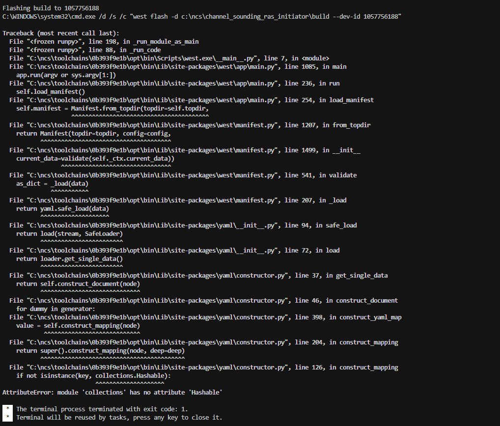

    2)  Also, how can I resolve the issues that appear after fixing the protobuf version by running
    C:\ncs\toolchains\0b393f9e1b\opt\bin\python.exe -m pip install nrfutil?

        if not isinstance(key, collections.Hashable):
    AttributeError: module 'collections' has no attribute 'Hashable'

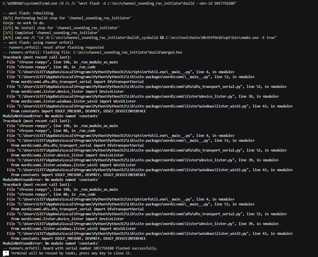

    after C:\ncs\toolchains\0b393f9e1b\opt\bin\python.exe -m pip install PyYAML=6.0.1 ,
    -- west flash: using runner nrfutil
    -- runners.nrfutil: reset after flashing requested
    -- runners.nrfutil: Flashing file: C:\ncs\channel_sounding_ras_initiator\build\merged.hex
    File "C:\ncs\toolchains\0b393f9e1b\opt\bin\Scripts\nrfutil.exe\__main__.py", line 4, in <module>
    File "C:\ncs\toolchains\0b393f9e1b\opt\bin\Lib\site-packages\nordicsemi\__main__.py", line 53, in <module>
    from nordicsemi.dfu.dfu_transport_serial import DfuTransportSerial
    File "C:\ncs\toolchains\0b393f9e1b\opt\bin\Lib\site-packages\nordicsemi\dfu\dfu_transport_serial.py", line 52, in <module>
    from nordicsemi.lister.device_lister import DeviceLister
    File "C:\ncs\toolchains\0b393f9e1b\opt\bin\Lib\site-packages\nordicsemi\lister\device_lister.py", line 39, in <module>
    from nordicsemi.lister.windows.lister_win32 import Win32Lister
    File "C:\ncs\toolchains\0b393f9e1b\opt\bin\Lib\site-packages\nordicsemi\lister\windows\lister_win32.py", line 43, in <module>
    from constants import DIGCF_PRESENT, DEVPKEY, DIGCF_DEVICEINTERFACE

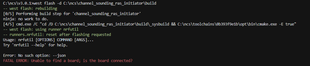

    In the end, it says that nrfutil does not recognize the --json option. How can I resolve this issue?
    Usage: nrfutil [OPTIONS] COMMAND [ARGS]...
    Try 'nrfutil --help' for help.
    Error: no such option: --json

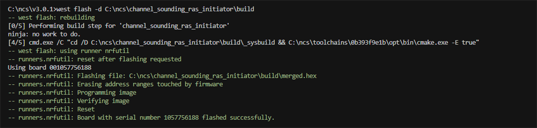

    -- runners.nrfutil: Board with serial number 1057756188 flashed successfully.

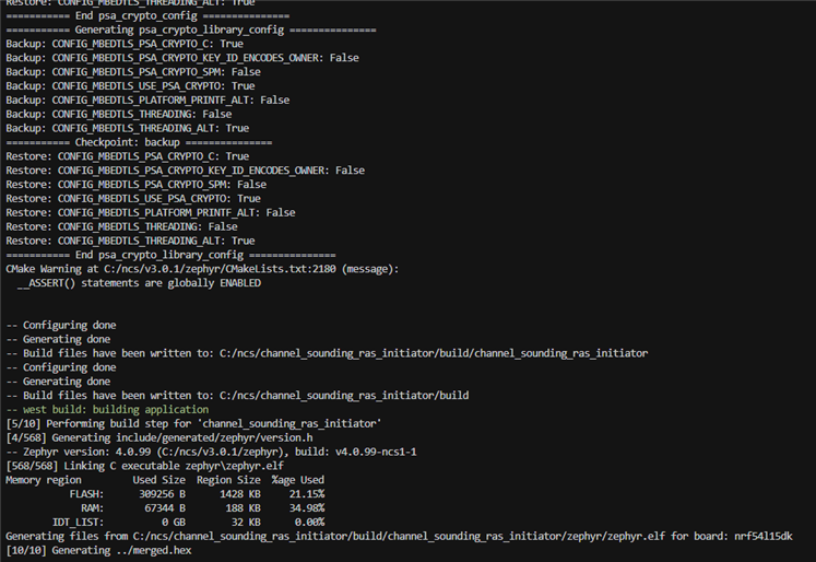

  • I see. I just tested building the channel_sounding_ras_initiator with both NCS v3.0.0 and v3.0.1 (I recommend that you move to 3.0.1), and none of them triggered any protobuf issues. I do see from your build log that it was, for some reason, trying to use your local version of python, located in "C:\Users\SJIT\AppData\Local\Programs\Python\Python312\Scripts\..." rather than the one from your toolchain.
    Also, after you "fixed it" by installing PyYAML, I am not sure what effect that will have on the toolchain. I suggest you remove the toolchain and reinstall it.

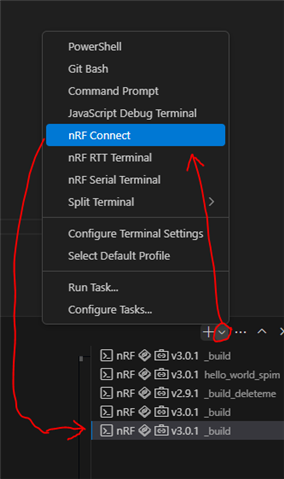

    After you do that, try the following. Make sure that the active build is the application that you are trying to build, and then click:
    Make sure that the toolchain listed is the one you are trying to use. Now, in that terminal, navigate to the root folder for the application:
    cd ..\..\
    and use this command to build:
    west build -b nrf54l15dk/nrf54l15/cpuapp -d build_2
    Does that build without any errors?

    Unfortunately, as shown in the image, I tried using the Build and Flash buttons in the nRF Connect SDK Toolchain v3.0.1, but the same error kept occurring.
    However, I was able to resolve the issue and successfully flash the device.
    I tried several methods:
    • Downloaded Python 3.10 and configured both the interpreter and system PATH to use it.
    • I downloaded nrfutil from www.nordicsemi.com/.../nrf-util, manually moved it to the folder C:\ncs\toolchains\0b393f9e1b\opt\bin\Scripts, and ran the command C:\ncs\toolchains\0b393f9e1b\opt\bin\Scripts\nrfutil.exe install device
  • According to google translate, this is what you wrote:
    Unfortunately, I tried using the Build and Flash buttons of the nRF Connect SDK Toolchain v3.0.1 as shown in the image, but I kept getting the same error.
    However, I was able to fix the issue and successfully run the flash.
    Download Python 3.10 and configure the interpreter and system PATH to use it.
    Download nrfutil from www.nordicsemi.com/.../nrf-util and manually place it and run the command nrfutil.exeC:\ncs\toolchains\0b393f9e1b\opt\bin\Scriptsnrfutil.exe install devic
    If you got it working, it is fine, I guess. But you may still run into other issues, if your toolchain is not being correctly set up when building your applications.
    Try building using this terminal and the command "west build -b <board_name> -d build_2"
    But if you have changed things inside the toolchain, I would recommend that you uninstall that toolchain and re-install it again. Building with the toolchain enabled should never try to access your "personal" python instance outside the toolchain.

    As you mentioned, I ran the following command:
    west build -b nrf54l15dk/nrf54l15/cpuapp -d C:\ncs\channel_sounding_ras_initiator\build
    CMake Error: CMake was unable to find a build program corresponding to "Ninja".  CMAKE_MAKE_PROGRAM is not set.  You probably need to select a different build
    tool.
    FATAL ERROR: command exited with status 1: 'C:\Program Files\CMake\bin\cmake.EXE' -DWEST_PYTHON=C:/Users/SJIT/AppData/Local/Programs/Python/Python310/python.exe '-BC:\ncs\channel_sounding_ras_initiator\build' -GNinja -DBOARD=nrf54l15dk/nrf54l15/cpuapp '-SC:\ncs\v3.0.1\zephyr\share\sysbuild' '-DAPP_DIR:PATH=C:\ncs\channel_sounding_ras_initiator'
    However, I encountered an issue with Ninja,
    but I was able to resolve it by adding the following to the PATH:
    set PATH=C:\ncs\toolchains\0b393f9e1b\opt\bin;%PATH%
    and the build was successful.
    However, when I first tried to flash using this command:
    C:\ncs\v3.0.1>west flash -d C:\ncs\channel_sounding_ras_initiator\build
    an error occurred.
    At that time, after I moved the downloaded nrfutil.exe file into C:\ncs\toolchains\0b393f9e1b\opt\bin,
    the flashing worked correctly.
    Thank you for your respons

  • Where did he try to type this command? Try calling it in an "nRF Connect" terminal in VS Code, like I showed in my reply the 27th of May.
    BR,
    Edvin
