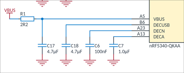

    • If you are using the USB peripheral, 5V from the USB connector must be supplied to the VBUS pin, and DECUSB needs a 4.7uF capacitor:

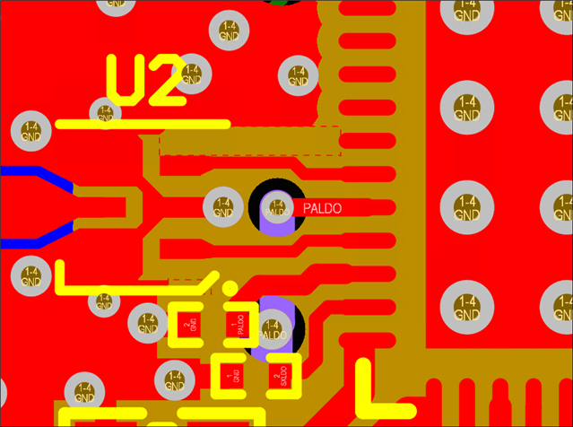

    • FL1 should be rotated and moved closer to the nRF7002, to minimize the length of the TXRF0 and TXRF1 traces, like in the nRF7002 reference layout:

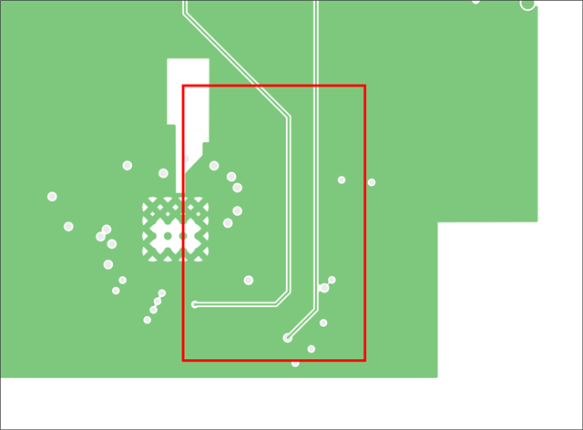

    • These 2 traces on the second layer must be rerouted, such that they don't cross under the RF traces from the nRF7002.
    • The thermal relief should be removed from the GND vias under the nRF7002 and nRF5340, these vias need a good connection the internal and bottom layer GND fills.

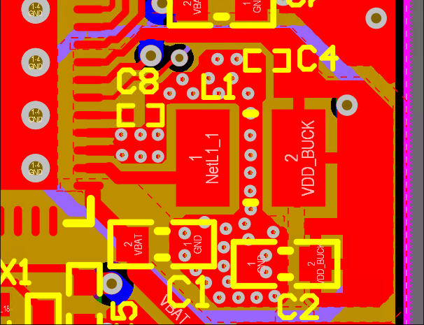

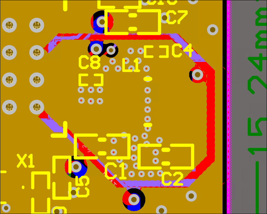

    • The grounding of C25, C26, C24 and C27 should go to the isolated part of the GND fill on the top layer, and connect to a semi isolated part of the L2 ground fill. This is done to sum the GND return currents and cancel out noise from the buck converter. Here is how this is done in the reference layout:
