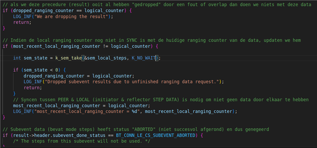

Ranging CS data from multiple connections

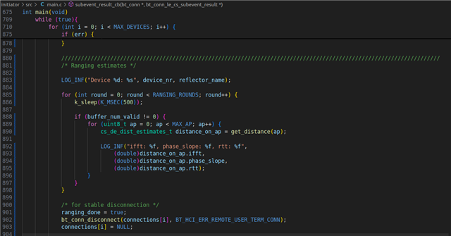

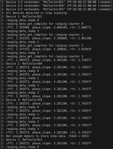

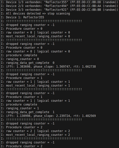

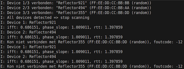

I succeeded in implementing Channel sounding for multiple devices (based on previous samples). But now there is a little difference in how the data gets collected (buffer) and how the range estimation gets computed (somewhere outside the files).
As you can see, the connections and scanning works already fine when i re-implement my code for reconnecting sequentially with the devices. But the data doesn't get updated correctly:
I think i should change some things in data collected / range data collect (the first 6 functions, which are new from the new sample)

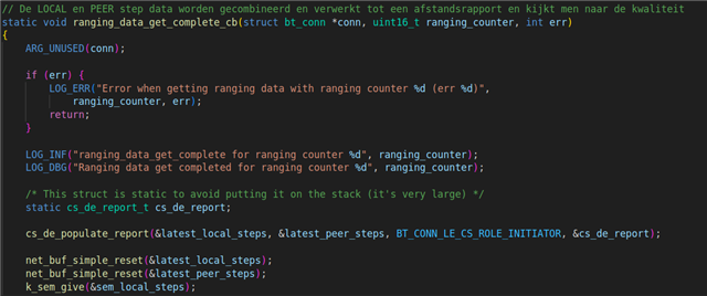

static void ranging_data_get_complete_cb(struct bt_conn *conn, uint16_t ranging_counter, int err)
	ARG_UNUSED(conn);
	if (err) {
		LOG_ERR("Error when getting ranging data with ranging counter %d (err %d)",
			ranging_counter, err);
		return;
	// LOG_DBG("Ranging data get completed for ranging counter %d", ranging_counter);
	/* This struct is static to avoid putting it on the stack (it's very large) */
	static cs_de_report_t cs_de_report;
	memset(&cs_de_report, 0, sizeof(cs_de_report));
	cs_de_populate_report(&latest_local_steps, &latest_peer_steps, BT_CONN_LE_CS_ROLE_INITIATOR,
			      &cs_de_report);
	net_buf_simple_reset(&latest_local_steps);
	net_buf_simple_reset(&latest_peer_steps);
	k_sem_give(&sem_local_steps);
	cs_de_quality_t quality = cs_de_calc(&cs_de_report);
	if (quality == CS_DE_QUALITY_OK) {
		for (uint8_t ap = 0; ap < cs_de_report.n_ap; ap++) {
			if (cs_de_report.tone_quality[ap] == CS_DE_TONE_QUALITY_OK) {
				store_distance_estimates(&cs_de_report);

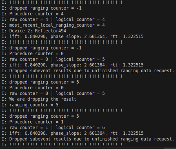

static void subevent_result_cb(struct bt_conn *conn, struct bt_conn_le_cs_subevent_result *result)
	if (dropped_ranging_counter == result->header.procedure_counter) {
		return;
	if (most_recent_local_ranging_counter
		!= bt_ras_rreq_get_ranging_counter(result->header.procedure_counter)) {
		int sem_state = k_sem_take(&sem_local_steps, K_NO_WAIT);
		if (sem_state < 0) {
			dropped_ranging_counter = result->header.procedure_counter;
			// LOG_DBG("Dropped subevent results due to unfinished ranging data request.");
			return;
		most_recent_local_ranging_counter =
			bt_ras_rreq_get_ranging_counter(result->header.procedure_counter);
	if (result->header.subevent_done_status == BT_CONN_LE_CS_SUBEVENT_ABORTED) {
		/* The steps from this subevent will not be used. */
	} else if (result->step_data_buf) {
		if (result->step_data_buf->len <= net_buf_simple_tailroom(&latest_local_steps)) {
			uint16_t len = result->step_data_buf->len;
			uint8_t *step_data = net_buf_simple_pull_mem(result->step_data_buf, len);
			net_buf_simple_add_mem(&latest_local_steps, step_data, len);
		} else {
			LOG_ERR("Not enough memory to store step data. (%d > %d)",
				latest_local_steps.len + result->step_data_buf->len,
				latest_local_steps.size);
			return;
	dropped_ranging_counter = PROCEDURE_COUNTER_NONE;
	if (result->header.procedure_done_status == BT_CONN_LE_CS_PROCEDURE_COMPLETE) {
	} else if (result->header.procedure_done_status == BT_CONN_LE_CS_PROCEDURE_ABORTED) {
		LOG_WRN("Procedure %u aborted", result->header.procedure_counter);

			/* Ranging estimates */
			LOG_INF("Device %d: %s", device_nr, reflector_name);
			for (int round = 0; round < RANGING_ROUNDS; round++) {
				k_sleep(K_MSEC(5000));
				if (buffer_num_valid != 0) {
					for (uint8_t ap = 0; ap < MAX_AP; ap++) {
						cs_de_dist_estimates_t distance_on_ap = get_distance(ap);
						LOG_INF("ifft: %f, phase_slope: %f, rtt: %f",
							(double)distance_on_ap.ifft,
							(double)distance_on_ap.phase_slope,
							(double)distance_on_ap.rtt);
			/* for stable disconnection */
			ranging_done = true;
			bt_conn_disconnect(connections[i], BT_HCI_ERR_REMOTE_USER_TERM_CONN);
			connections[i] = NULL;
			k_sem_take(&sem_ranging_done, K_FOREVER);
			ranging_done = false;
  • So, I have come to solutions myself, but there is only 1 problem left for me:
    PROBLEM:
    We get this working chronology now, and i already understand all of the functions quite good... But for multiple connections handled sequentially, there is a problem of the counters and that the buffer doesn't get updated correctly. I want to know how to handle this correctly and how to solve this problem.
    The problem is thus, that we don't get in this data_complete function, where we collect the step data from the PEER and LOCAL device to create the cs_de_report and to eventually get our new DISTANCE ESTIMATES:
    I would like this to work by Thursday, so i someone could help i would be very happy.

    // De LOCAL en PEER step data worden gecombineerd en verwerkt tot een afstandsrapport en kijkt men naar de kwaliteit
    	ARG_UNUSED(conn);
    	if (err) {
    		return;
    	LOG_INF("ranging_data_get_complete for ranging counter %d", ranging_counter);
    	cs_de_populate_report(&latest_local_steps, &latest_peer_steps, BT_CONN_LE_CS_ROLE_INITIATOR, &cs_de_report);
    	// HIER WORDEN DE BEREKENINGEN GEDAAN IN "cs_de.c" EN IN ONS cs_de_report GEZET
    				store_distance_estimates(&cs_de_report);	// Afstandsrapport wordt hier bewaard
    // MANAGED binnenkomende step data van de LOCAL (initiator) in result
    	// als we deze precedure (result) ooit al hebben "gedropped" door een fout of overlap dan doen we niets met deze data
    		return;
    	// Indien de local ranging counter nog niet in SYNC is met de huidige ranging counter van de data, updaten we hem
    	if (most_recent_local_ranging_counter != bt_ras_rreq_get_ranging_counter(result->header.procedure_counter)) {
    			return;
    		// Syncen tussen PEER & LOCAL (initiator & reflector STEP DATA) is nodig om niet geen data door elkaar te hebben
    		most_recent_local_ranging_counter = bt_ras_rreq_get_ranging_counter(result->header.procedure_counter);
    	// Subevent data (bevat mode steps) heeft status "ABORTED" (niet succesvol afgerond) en dus genegeerd
    	// Subevent STEP DATA succesvol afgerond => data in Latest Local Steps (Memory van onze initiator) geplaatst
    		} else {
    			// We drop this procedure
    			return;
    	// Procedure COMPLETED :)
    				k_sleep(K_MSEC(500));

    I am still trying to fix it myself, i have found the cause of my problem, but i need some help interpretting the "DROPPED counter"
    I now have implemented a logical counter, which is a counter that keeps in track with the real counter, because now we keep resetting the counter, due to multiple device re-connections.
    as you can see, there are always 2 subevents for 1 procedure. For the first device, it works perfectly.
    But then i tried modifying the code and i tried to work with a logical counter, which keeps in track of the TRUE count.
    But i am affraid that we now have other problems for the next devices in line:
    i think the problem has actually to do with the fact that for my last ranging round, it doesn't finish with doing the ranging properly. Look at what i do in the main.c to get all the ranging estimates:
    Therefore i come in this line of code "Dropped subevent results...":
    So, if you can help me, or know someone who can really fix this as soon as possible, i would be very thankful.
    I need to get this running tomorrow to do my measurements on Thursday (in 2 days)

    Briefly looking at your code. The sample there is intended for a single link. Extending it to make it work with multiple ACLs is non-trivial and would take a bit more work than what you have done there, every connection needs to be managed separately, probably with separate semaphores/queues for the local steps.
    The controller connected to multiple devices will produce steps for each connection, and the ranging counters are not shared between these. The ranging data from different connections cannot be mixed either.
    Not really understand your comments in the code. I don't speak Dutch.
    Is it possible to get some concrete code as examples on how to do it?
    Also, i am wondering if the parallel connections would work better than sequential connections?
    I am really struggling now with this code, since i don't know everything on how it should work...
