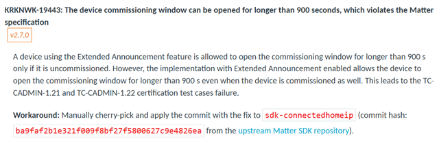

2. _TC-CADMIN-1.22: step 5: got success response instead of Invalid command

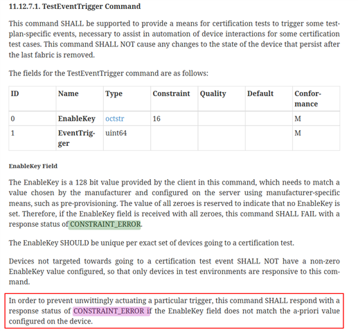

3. _TC-DGGEN-2.3: Step 3: got Constraint Error instead of Invalid Command
    Could you add the log for this step as well?
    I might need some more time looking into this one, but in the meanwhile could you refer to 11.12.7.1 in the Matter spec and see if you've configured it according to the spec?

  • Could you add the log for this step as well?
    Ans: Pls find attached file for log.CADMIN-1-22_2025_05_10_21_26_12.log

    FAIL_TC-CADMIN-1.22.txt
  • Hi Team,
    Found issue in SDK 2.7.0
    Himansu
