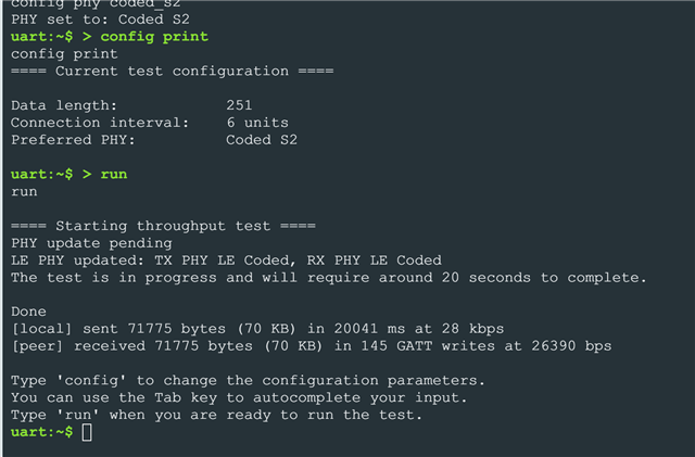

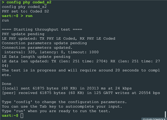

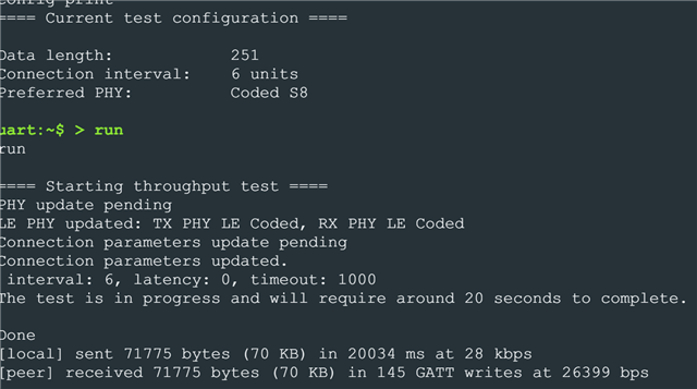

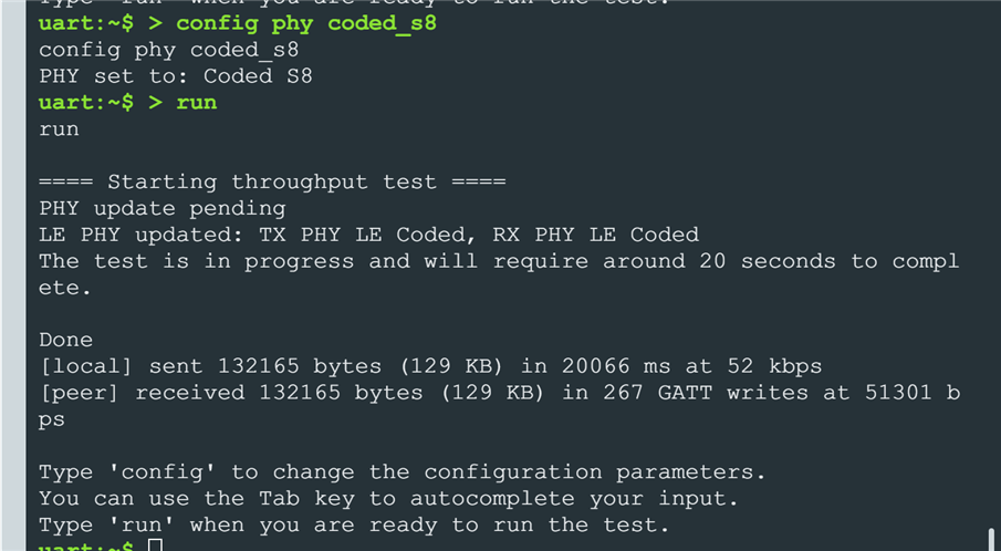

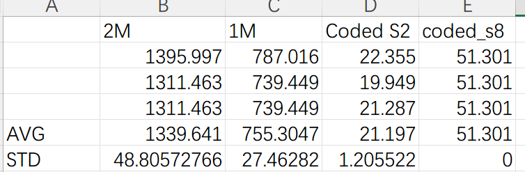

Hi, I am using two nRF54L15 DKs running THroughput samples.
The result of coded s8 is 52kbps, which is close to the theory number.
When I change to S2 code, the result is 24kbps, which is quite weired:
What is happening here, could you give me some advice?
