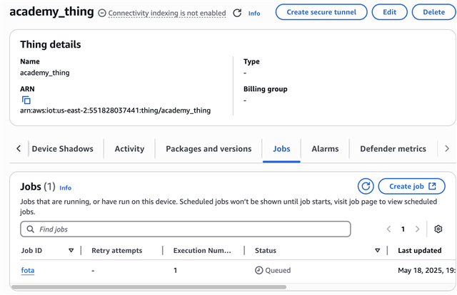

I followed the DevAcademy lesson on WiFi FOTA with AWS IoT, with some modifications to work with my board.
The device correctly connects to the AWS mqtt server and published events, etc. However, I followed the instructions for creating a FOTA job and I submitted the job. But it seems the job is stuck in "queued" mode and never starts. What might be the issue?

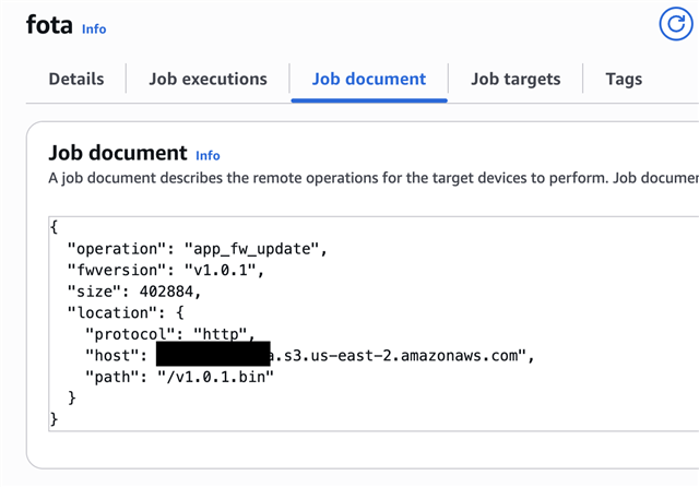

  • I  enabled AWS FOTA debug logging and am seeing this:
    00:00:34.211,944] <dbg> aws_fota: topic_type_get: Received topic: $aws/things/80380020C920/jobs/$next/get/accepted
    [00:00:34.211,975] <dbg> aws_fota: on_publish_evt: Checking for an available job
    [00:00:34.212,066] <dbg> aws_fota: parse_job_execution: Job doc: {"clientToken":"","timestamp":1747612515}
    [00:00:34.212,371] <dbg> aws_fota: parse_job_execution: Got only one field
    [00:00:34.212,402] <dbg> aws_fota: parse_job_execution: No queued jobs for this device
    Not sure what it means. It looks like it is receiving an incorrect job document?
    I added some logging and it seems that the job document is indeed
    {"clientToken":"","timestamp":1747613442}
    Which is weird because in the AWS IOT job document page it shows:
      "operation": "app_fw_update",
      "fwversion": "v1.0.1",
      "size": 402884,
      "location": {
        "protocol": "http",
        "host": "my-bucket.s3.us-east-2.amazonaws.com",
        "path": "/v1.0.1.bin"
