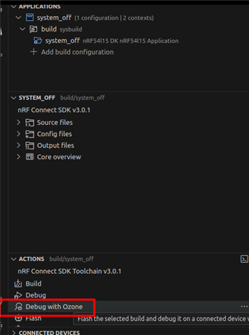

    I find it a bit surprising that all the stacked registers are zeroed. If the stack content is corrupted due to an overflow, it usually leads to more arbitrary values. It's also interesting that this occurs after the download is complete. Could you please try to debug this in Segger Ozone and set a data breakpoint at the MMFAR Address and see if you are able to catch the write that triggered the stack guard?
    Segger Ozone should appear here if installed:
