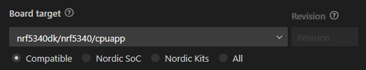

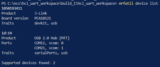

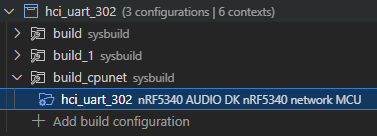

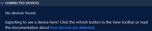

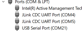

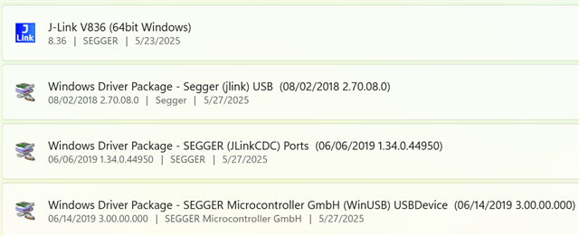

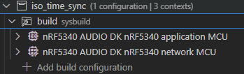

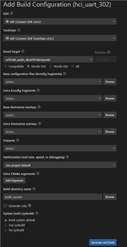

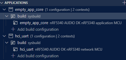

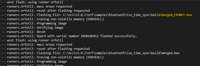

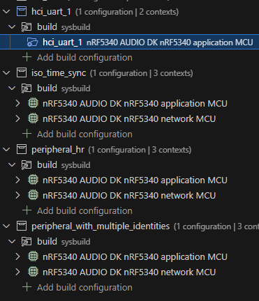

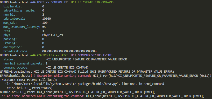

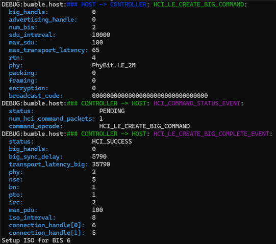

There is a problem sending auracast
I use nRF5340 audio DK,iso_time_sync example, can successfully send BIS data, then I use DK as controller, bumble(google.github.io/.../index.html) as host and it fails to send.
 I don't understand what went wrong. Can you give me some advice?

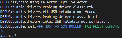

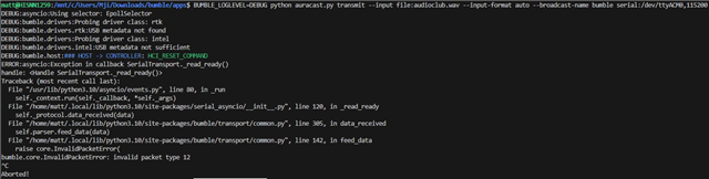

Here is the entire log
/mnt/c/Users/Mji/Downloads/bumble/apps$ BUMBLE_LOGLEVEL=DEBUG python auracast.py transmit --input file:audiomono.wav --input-format auto --broadcast-name bumble serial:/dev/ttyACM0,115200

Only 2 channels PCM configurations are supported
matt@HISNN1259:/mnt/c/Users/Mji/Downloads/bumble/apps$ BUMBLE_LOGLEVEL=DEBUG python auracast.py transmit --input file:audioclub.wav --input-format auto --broadcast-name bumble serial:/dev/ttyACM0,115200

DEBUG:bumble.host:### HOST -> CONTROLLER: HCI_LE_CREATE_BIG_COMMAND:
  big_handle:            0
  advertising_handle:    0
  num_bis:               2
  sdu_interval:          10000
  max_sdu:               100
  max_transport_latency: 65
  rtn:                   4
  phy:                   PhyBit.LE_2M
  packing:               0
  framing:               0
  encryption:            0
  broadcast_code:        00000000000000000000000000000000
DEBUG:bumble.host:### CONTROLLER -> HOST: HCI_COMMAND_STATUS_EVENT:
  status:                  HCI_UNSUPPORTED_FEATURE_OR_PARAMETER_VALUE_ERROR
  num_hci_command_packets: 1
  command_opcode:          HCI_LE_CREATE_BIG_COMMAND
WARNING:bumble.host:HCI_LE_CREATE_BIG_COMMAND failed (HCI_UNSUPPORTED_FEATURE_OR_PARAMETER_VALUE_ERROR)
ERROR:bumble.host:!!! Exception while sending command: HCI_Error(hci/HCI_UNSUPPORTED_FEATURE_OR_PARAMETER_VALUE_ERROR [0x11])
  File "/home/matt/.local/lib/python3.10/site-packages/bumble/host.py", line 683, in send_command
    raise hci.HCI_Error(status)
bumble.hci.HCI_Error: HCI_Error(hci/HCI_UNSUPPORTED_FEATURE_OR_PARAMETER_VALUE_ERROR [0x11])
!!! An error occurred while executing the command: HCI_Error(hci/HCI_UNSUPPORTED_FEATURE_OR_PARAMETER_VALUE_ERROR [0x11])
    Which NCS version are you using? Could you try the latest version, v3.0.1?
    Amanda H.
  • I used the hci uart in v3.0.2, but still got the same error
    DEBUG:asyncio:Using selector: EpollSelector
    DEBUG:bumble.drivers:Probing driver class: rtk
    DEBUG:bumble.drivers.rtk:USB metadata not found
    DEBUG:bumble.drivers:Probing driver class: intel
    DEBUG:bumble.drivers.intel:USB metadata not sufficient

    Setup BIG
    /mnt/c/Users/Mji/Downloads/bumble/apps/auracast.py:948: FutureWarning: Only for testing.
      big = await device.create_big(
      big_handle:            0
      num_bis:               2
      sdu_interval:          10000
      max_sdu:               100
      rtn:                   4
      phy:                   PhyBit.LE_2M
      packing:               0
      framing:               0
      encryption:            0
  • Hi, Sorry for the late reply.
    I don't know how to do this: build the hci_uart sample with EXTRA_CONF_FILE='debug.conf' and connect the net core via RTT to check if it works as expected.
    I recompiled the hci uart example according to docs.nordicsemi.com/.../hci_logger.html
    But when I use bumble to test, It looks like there is a problem with hci communication
    I enabled Monitor protocol over UART, so prj.conf will increase CONFIG_BT_DEBUG_MONITOR_UART=y and reduce CONFIG_CONSOLE=n.
    It appears that Bumble is attempting to initialize the controller, but is receiving invalid responses. Does the hci_uart work as expected?
    Do you get the same result if testing with the NCS v3.0.2 iso_time_sync sample?

  • Hi Amanda, I don't quite understand this question: "Does the hci_uart work as expected?"
    I can run the iso_time_sync example on the nRF5340 audioDK without issue.
    I have some doubts whether the combination of hci_uart as net core and empty_app_core as app core can work properly.
    You can see my original question, I use hci uart as app core, the net core image of other examples, the controller is responsive.
    According to the figure, it shows the controller doesn't support "creating BIG".
    Probably you just use the default setting of the controller configs.
    You can refer to the configs used in the audio project:
    https://github.com/nrfconnect/sdk-nrf/blob/v3.0.2/applications/nrf5340_audio/sysbuild/ipc_radio/prj.conf
    Since the default one for hci_uart might not enable LE audio-related features.
  • I added the prj.conf in the link, and compilation errors occurred:
     *  Executing task: nRF Connect: Generate config nrf52840dongle/nrf52840 for c:\ncs\bumble\hci_uart_0805-2
    Building hci_uart_0805-2
    C:\Windows\system32\cmd.exe /d /s /c "west build --build-dir c:/ncs/bumble/hci_uart_0805-2/build c:/ncs/bumble/hci_uart_0805-2 --pristine --board nrf52840dongle/nrf52840 -- -DBOARD_ROOT=c:/ncs/bumble/hci_uart_0805-2"
    -- Found Python3: C:/ncs/toolchains/0b393f9e1b/opt/bin/python.exe (found suitable version "3.12.4", minimum required is "3.10") found components: Interpreter
    -- Cache files will be written to: C:/ncs/v3.0.2/zephyr/.cache
    -- Board: nrf52840dongle, qualifiers: nrf52840
    Parsing C:/ncs/v3.0.2/zephyr/share/sysbuild/Kconfig
    Loaded configuration 'C:/ncs/bumble/hci_uart_0805-2/build/_sysbuild/empty.conf'
    Merged configuration 'C:/ncs/bumble/hci_uart_0805-2/build/_sysbuild/empty.conf'
    Configuration saved to 'C:/ncs/bumble/hci_uart_0805-2/build/zephyr/.config'
    Kconfig header saved to 'C:/ncs/bumble/hci_uart_0805-2/build/_sysbuild/autoconf.h'
       * Running CMake for hci_uart_0805-2 *
    -- Application: C:/ncs/bumble/hci_uart_0805-2
    -- CMake version: 3.21.0
    -- Zephyr version: 4.0.99 (C:/ncs/v3.0.2/zephyr)
    -- Found host-tools: zephyr 0.17.0 (C:/ncs/toolchains/0b393f9e1b/opt/zephyr-sdk)
    -- Found toolchain: zephyr 0.17.0 (C:/ncs/toolchains/0b393f9e1b/opt/zephyr-sdk)
    -- Found Dtc: C:/ncs/toolchains/0b393f9e1b/opt/bin/dtc.exe (found suitable version "1.4.7", minimum required is "1.4.6")
    -- Found BOARD.dts: C:/ncs/v3.0.2/zephyr/boards/nordic/nrf52840dongle/nrf52840dongle_nrf52840.dts
    -- Generated zephyr.dts: C:/ncs/bumble/hci_uart_0805-2/build/hci_uart_0805-2/zephyr/zephyr.dts
    -- Generated pickled edt: C:/ncs/bumble/hci_uart_0805-2/build/hci_uart_0805-2/zephyr/edt.pickle
    -- Generated devicetree_generated.h: C:/ncs/bumble/hci_uart_0805-2/build/hci_uart_0805-2/zephyr/include/generated/zephyr/devicetree_generated.h
    -- Including generated dts.cmake file: C:/ncs/bumble/hci_uart_0805-2/build/hci_uart_0805-2/zephyr/dts.cmake
    warning: MPSL_TRIGGER_IPC_TASK_ON_RTC_START (defined at
    C:/ncs/v3.0.2/nrf\subsys\mpsl\init/Kconfig:50) was assigned the value 'y' but got the value 'n'.
    Check these unsatisfied dependencies: SOC_NRF5340_CPUNET (=n). See
    http://docs.zephyrproject.org/latest/kconfig.html#CONFIG_MPSL_TRIGGER_IPC_TASK_ON_RTC_START and/or
    look up MPSL_TRIGGER_IPC_TASK_ON_RTC_START in the menuconfig/guiconfig interface. The Application
    Development Primer, Setting Configuration Values, and Kconfig - Tips and Best Practices sections of
    the manual might be helpful too.
    warning: MPSL_TRIGGER_IPC_TASK_ON_RTC_START_CHANNEL (defined at
    C:/ncs/v3.0.2/nrf\subsys\mpsl\init/Kconfig:59) was assigned the value '4' but got the value ''.
    Check these unsatisfied dependencies: MPSL_TRIGGER_IPC_TASK_ON_RTC_START (=n). See
    http://docs.zephyrproject.org/latest/kconfig.html#CONFIG_MPSL_TRIGGER_IPC_TASK_ON_RTC_START_CHANNEL
    and/or look up MPSL_TRIGGER_IPC_TASK_ON_RTC_START_CHANNEL in the menuconfig/guiconfig interface. The
    Application Development Primer, Setting Configuration Values, and Kconfig - Tips and Best Practices
    sections of the manual might be helpful too.
    warning: BT_CTLR_DTM_HCI (defined at subsys/bluetooth\controller\Kconfig.dtm:14) was assigned the
    value 'y' but got the value 'n'. Check these unsatisfied dependencies: BT_CTLR_DTM_HCI_SUPPORT (=n).
    See http://docs.zephyrproject.org/latest/kconfig.html#CONFIG_BT_CTLR_DTM_HCI and/or look up
    BT_CTLR_DTM_HCI in the menuconfig/guiconfig interface. The Application Development Primer, Setting
    Configuration Values, and Kconfig - Tips and Best Practices sections of the manual might be helpful
    too.
    Parsing C:/ncs/v3.0.2/zephyr/Kconfig
    Loaded configuration 'C:/ncs/v3.0.2/zephyr/boards/nordic/nrf52840dongle/nrf52840dongle_nrf52840_defconfig'
    Merged configuration 'C:/ncs/bumble/hci_uart_0805-2/prj.conf'
    Merged configuration 'C:/ncs/bumble/hci_uart_0805-2/boards/nrf52840dongle_nrf52840.conf'
    Merged configuration 'C:/ncs/bumble/hci_uart_0805-2/build/hci_uart_0805-2/zephyr/.config.sysbuild'
    C:/ncs/bumble/hci_uart_0805-2/prj.conf:66: warning: attempt to assign the value 'y' to the undefined symbol IPC_RADIO_BT
    C:/ncs/bumble/hci_uart_0805-2/prj.conf:67: warning: attempt to assign the value 'y' to the undefined symbol IPC_RADIO_BT_HCI_IPC
    error: Aborting due to Kconfig warnings
    CMake Error at C:/ncs/v3.0.2/zephyr/cmake/modules/kconfig.cmake:396 (message):
      C:/ncs/v3.0.2/nrf/cmake/modules/kconfig.cmake:36 (include)
      C:/ncs/v3.0.2/zephyr/cmake/modules/zephyr_default.cmake:133 (include)
      C:/ncs/v3.0.2/zephyr/share/zephyr-package/cmake/ZephyrConfig.cmake:66 (include)
      C:/ncs/v3.0.2/zephyr/share/zephyr-package/cmake/ZephyrConfig.cmake:92 (include_boilerplate)
      CMakeLists.txt:5 (find_package)
    CMake Error at cmake/modules/sysbuild_extensions.cmake:514 (message):
      CMake configure failed for Zephyr project: hci_uart_0805-2
      Location: C:/ncs/bumble/hci_uart_0805-2
      cmake/modules/sysbuild_images.cmake:43 (ExternalZephyrProject_Cmake)
      cmake/modules/sysbuild_default.cmake:21 (include)
      C:/ncs/v3.0.2/zephyr/share/zephyr-package/cmake/ZephyrConfig.cmake:75 (include)
      C:/ncs/v3.0.2/zephyr/share/sysbuild-package/cmake/SysbuildConfig.cmake:8 (include)
      template/CMakeLists.txt:10 (find_package)
    See also "C:/ncs/bumble/hci_uart_0805-2/build/CMakeFiles/CMakeOutput.log".
    FATAL ERROR: command exited with status 1: 'C:\ncs\toolchains\0b393f9e1b\opt\bin\cmake.EXE' -DWEST_PYTHON=C:/ncs/toolchains/0b393f9e1b/opt/bin/python.exe '-Bc:\ncs\bumble\hci_uart_0805-2\build' -GNinja -DBOARD=nrf52840dongle/nrf52840 -DBOARD_ROOT=c:/ncs/bumble/hci_uart_0805-2 '-SC:\ncs\v3.0.2\zephyr\share\sysbuild' '-DAPP_DIR:PATH=c:\ncs\bumble\hci_uart_0805-2'
