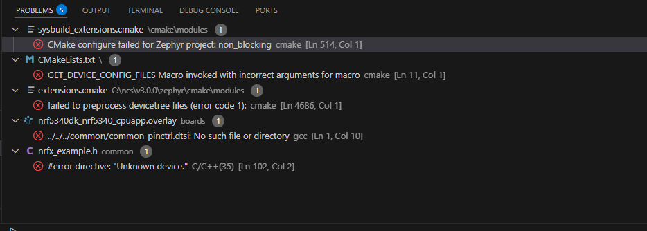

    • However, when I try to build the project, I get the following errors:
CMake Error at cmake/modules/sysbuild_extensions.cmake:514 (message)
CMake Error at C:/ncs/v2.9.1/zephyr/cmake/modules/dts.cmake:295 (execute_process)
CMake Error at C:/ncs/v2.9.1/zephyr/cmake/modules/dts.cmake:339 (message)
CMake Error at C:/ncs/v2.9.1/zephyr/cmake/modules/extensions.cmake:2993 (file)
Kconfig Language Server cannot start for build 'build'. Try rebuilding or do the pristine build to fix this issue.
I’m not sure what’s causing these errors. Could it be a misconfiguration in the overlay file or something else?

  • I used version 3.0.0 during the build process with the target board nrf5340dk/nrf5340/cpuapp, using the default Devicetree overlay (board/nrf5340dk/nrf5340/cpuapp.overlay). However, the issue still persists.

    I'm assuming you tried to copy the sample?
    Unfortunately, the samples in the nrfx folder won't build outside of its folder without doing some modifications to it. That is due some dependencies of CMAKELIST.txt file. The easiest for testing this sample would be to either just build the application where it is, or start a new project and just copy main.c and add
    CONFIG_NRFX_SPIM1=y to the project config.
    Note that the samples are not using any Zephyr drivers. If you are planning to use this in a project then the example in our Devacademy is probably the best start. There we show you how to use the Zephyr API for SPI.

  • Let me briefly explain my situation: I’m using Visual Studio Code with the nRF Connect extension. I selected the nrfx_spim non-blocking sample and added the following configuration line to my prj.conf file:CONFIG_NRFX_SPIM1=y
    However, the build fails, even though I correctly selected the development kit and the overlay file in the build configuration.
    As for Zephyr, I haven’t made any changes to it
    Did you open the existing sample, or did you copy the sample?
    If you copy the sample, see this:
    Also, probably better to follow the Devacademy course on SPI as I mentioned in my last reply,
