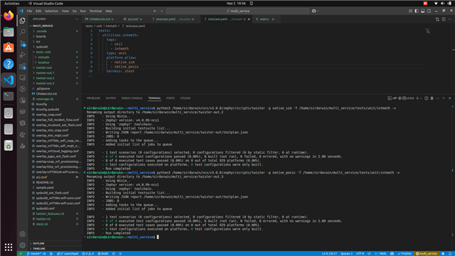

  • Hİ Dejan,
    I uninstalled all folders belongs to zephyr and nRF like ncs, nrf connect from vs code and zephyr folders from computer, then I installed them again I also removed the zephyr's path from the /.bashrc. After this process, result wasn't different. However, I decided to open some space in my computer because it was around 100-200MB space left. I opened more than 5GB space and this time result was different, I didn't get any error with native_sim.
    This is good part, but now I have a different question.
    I copied the intmath test from https://github.com/nrfconnect/sdk-zephyr/tree/v4.0.99-ncs1/tests/unit to see if my tests are wrong.
    Here are the results,
    native_sim and native_posix: I just added the necessary platform_allow and harness informations to the testcase.yaml file and tried to run with it. There are no error but tests are not executed. If I add build_only: false or build_only: true option, results are the same with native platforms.
        platform_allow:
          - native_sim
          - native_posix
        harness: ztest
    My run commands are:
    python3 /home/sirdarwin/ncs/v3.0.0/zephyr/scripts/twister -p native_posix -T /home/sirdarwin/multi_service/tests/unit/intmath -v
    python3 /home/sirdarwin/ncs/v3.0.0/zephyr/scripts/twister -p native_sim -T /home/sirdarwin/multi_service/tests/unit/intmath -v

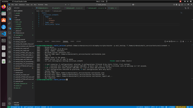

    unit_testing: This platform is working as expected, I run the command "python3 /home/sirdarwin/ncs/v3.0.0/zephyr/scripts/twister -p unit_testing -T /home/sirdarwin/multi_service/tests/unit/intmath -v" and its working properly, even if I add build_only: false to the testcase.yaml file here is the result,
    Can I assume that this unit test worked properly? because I didn't added the unit_testing platform.
    What is the difference between unit_testing platform and native platforms?
    Can I use that unit_testing platform for my all types of unit testing, I'm also open for another recommendations?
    Why its not execute in native platforms?
  • Hİ Dejan,
        platform_allow:
          - native_sim
          - native_posix
        harness: ztest
    You can start by looking at Unit Testing Quick Start"type:unit" in test yaml means it is supposed to only run on "unit_testing" platform. This is a setup to load only minimal functionality from zephyr to allow building apps and executing them with mocks on your host. Please note that native_posix is depricated (native_sim replaces it). Native_sim is a "full" platform, and that is why a lot of stuff will be missing when one starts with "unit_testing". Unit tests (using the board unit_testing) are intended to run on your host system and thus are a bit different than running on embedded target. There are some tests in Zephyr that can be built both using unit_testing as the target board or targeting an embedded target. Here is one example of such tests.
