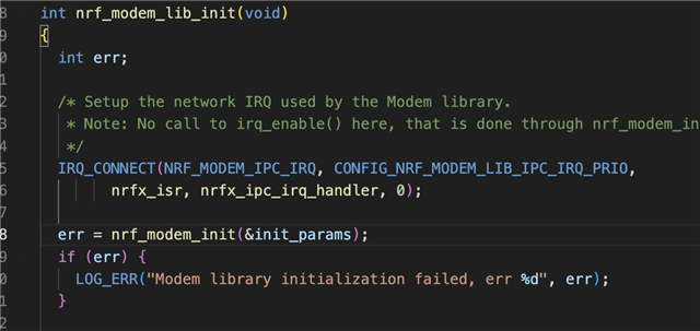

nrf_modem_lib_init() gets stuck and never finishes for some boards
Our nrf9151 boards are getting stuck when nrf_modem_lib_init() is called.
We just see this line. Usually, the device gets past it in less than a second.
[00:00:00.376,983] <dbg> mqtt_helper: mqtt_helper_poll_loop: Waiting for connection_poll_sem

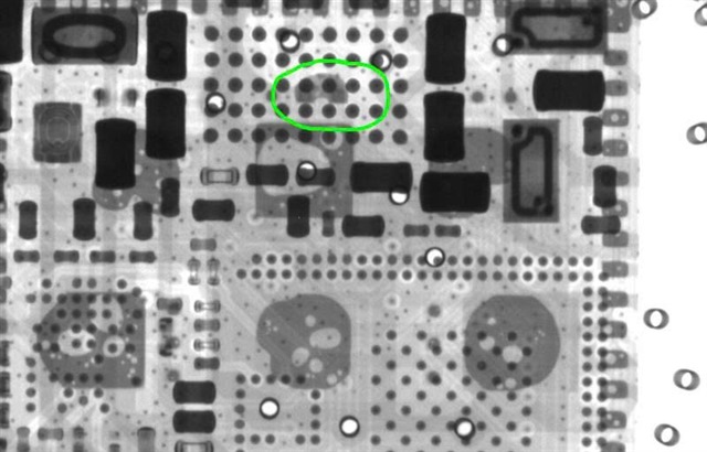

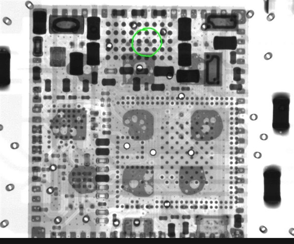

  • We do agree it appears to be an issue with the PCB board. We used the same board with the nrf9160 and only made the changes we needed to switch to the nrf9151, following Nordics guidelines. We printed the boards with JLCPCB.
    We noticed some potential shorts from the chip X-Ray attached (green circles indicate potential shorts).
    Any chance this has been seen by anybody else?

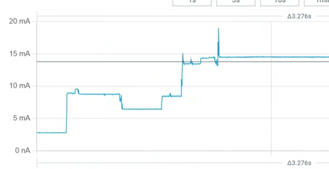

    This is a common scenario when that row of reserved pins are connected to each other.
    On the second image, there is a solder blob on the reserved pins, where the RESERVED pin is shorted to another RESERVED pin, which explains the high current consumption.
    This will cause the modem not to boot-up properly, and draw excessive current. You will be able to program your application, but any communication with the modem will hang in the IPC handler, as you've already shared.
