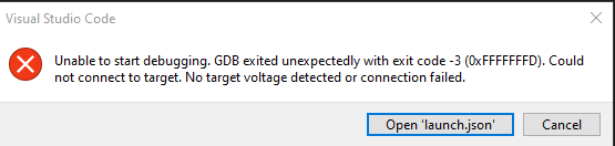

When I try to enter debug mode (following the usual way outlined in the dev academy course) - I get the following message:
'Unable to start debugging. GDP exited unexpectedly with exit code -3 (0xFFFFFFFD). Could not connect to target. No target voltage detected or connection failed.'

    Regarding this '''Unable to start debugging. GDP exited unexpectedly with exit code -3 (0xFFFFFFFD). Could not connect to target. No target voltage detected or connection failed.'' error, it may indicate the custom board is not properly powered.
    You can check the power supply if it is properly powered, check the debug connections and cables. Trying with external debugger could be an alternative choice if onboard debugger does not work. In addition to there, try power cycling the board and erase the board completely before flashing.
