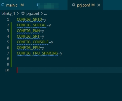

I’m using nRF Connect SDK (NCS) v2.8.0 with the blinky example.nrf54l15dk, In the project, I configured the following in Kconfig:
kconfig
CONFIG_FPU=y
CONFIG_FPU_SHARING=y

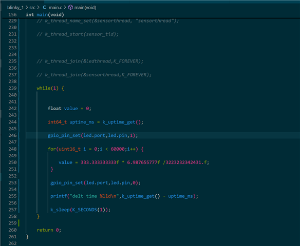

In the main function, I performed floating-point calculations with the following code and measured the execution time (~2.7 ms) by toggling a GPIO pin.
However, when I disabled the FPU by setting:
kconfig
CONFIG_FPU=n
CONFIG_FPU_SHARING=n
and recompiled, the measured execution time remained unchanged (still ~2.7 ms).
Question:
Why is there no performance difference? Are there additional configurations required to properly enable/disable the FPU?
