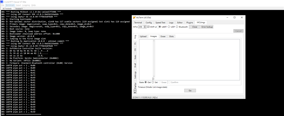

 I am learning how to use DFU over UART from the application in Devacademy l9/e2 , it works fine using the example , after that i try it on my own project but because my project use one uart only , so UART DFU and my APP use the same uart(UART0) , and i added two config
CONFIG_SHELL=y
CONFIG_MCUMGR_TRANSPORT_SHELL=y
also init uart0 in my application
void uart0_init(void)
    uint32_t err =  device_is_ready( dev_uart0 );
    if( err != true )
        printk("\nUART_init_err = %d\n", err);
    uart_irq_callback_user_data_set(dev_uart0,uart0_irq_callback, NULL )
    uart_irq_rx_enable( dev_uart0 );
i use Auterm(v0.35a) to Get image , Auterm data keep running into my uart0_irq_callback , not into MCUMGR shell
is there any way to let my application uart and uart dfu use the same uart and the same time without deinit the uart ? Thanks!

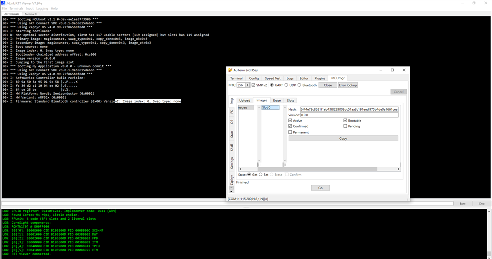

  • Hi
        Still not working , actually i can see DFU feedback from jlink RTT viewer with my original prj.conf settings.
    The only difference between success and fail is whether UART0 irq callback was intiailized by
    uart_irq_callback_user_data_set API in the beginning, Is there any way to disable my irq callback? i tried uart_irq_callback_user_data_set(dev_uart0, NULL, NULL) but its not working.
    Fail
    success
