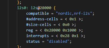

  • shak2300 said:
    Is there any way to see which peripherals are active?
    You need to check zephyr.dts and see if the peripheral binding has the 'status="disabled"' property. As shown below
