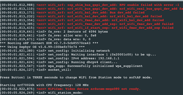

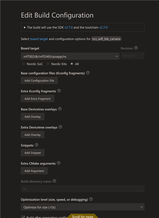

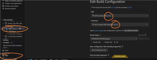

I am using nrf70-wifi-ble-image-transfer-demo in the nRF7002 DK.
I change nothing on the code form the sample, after patching I have succesfully build the code and then flash to the borad.

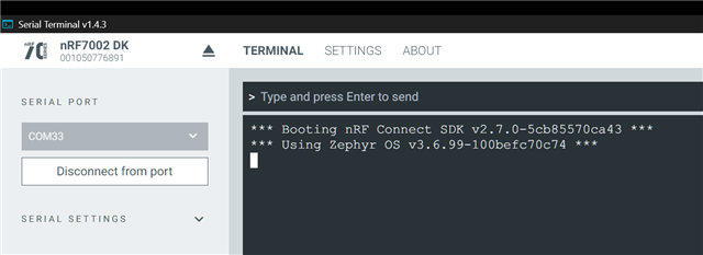

However, after flashing, there is nothing happending on the nRF7002 DK,even no printing printk("Starting %s with CPU frequency: %d MHz\n", CONFIG_BOARD, SystemCoreClock / MHZ(1));
I checked RTT there is nothing, and the serial terminal will only shows:
I try to debug but when I enter the dubug it can not stop by the main function.
Could you please help me on this, thank you so much!

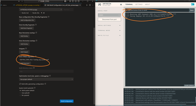

  • hello,
    I have use the code in UDP and BLE, it's OK.
    However, when I use the TCP with BLE, anytime I connect BLE, there will be error:
    [00:00:17.011,077] <inf> app_bluetooth: MTU Updated: tx 23, rx 23
    uart:~$ [00:00:17.011,169] <inf> app_bluetooth: Connected 75:39:25:FB:85:51 (random)
    uart:~$ MTU exchange pending
    uart:~$ [00:00:17.012,176] <inf> WiFiCam: Bluetooth connection established
