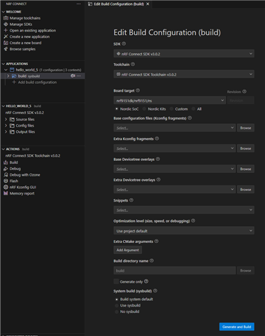

  • Create a project from scratch based on hello_world.
    Selected nrf9151dk/nrf9151dk as board.
    Build the project.
    Now add a devicetree overlay called error.dts. Put some garbage in the file.
    In the build configuration select Generate and Build and close the view.
    Now you get a build error:
    See also "D:/Workspaces/hello_world_5/build/CMakeFiles/CMakeOutput.log".
    FATAL ERROR: command exited with status 1: 'D:\ncs\toolchains\0b393f9e1b\opt\bin\cmake.EXE' -DWEST_PYTHON=D:/ncs/toolchains/0b393f9e1b/opt/bin/python.exe '-Bd:\Workspaces\hello_world_5\build' -GNinja -DBOARD=nrf9151dk/nrf9151/ns -DDTC_OVERLAY_FILE=error.dts -DBOARD_ROOT=d:/nrfboards '-SD:\ncs\v3.0.2\zephyr\share\sysbuild' '-DAPP_DIR:PATH=d:\Workspaces\hello_world_5'

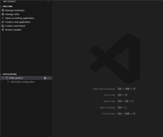

    * The terminal process terminated with exit code: 1.
    * Terminal will be reused by tasks, press any key to close it.
    The build configuration is gone:
    This is of course not how it happens normally, it would be a real board DTS and it would be a real project.
    You are unable to get the build configuration back, and will have to create a new one.
    How did you include error.dts in your build when you got build error?
