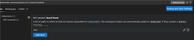

    There are two places they are collected. If you want to manually add and remove some board root directories, you can do so in the nRF Connect for VS Code extension settings:
    But there you can only remove the ones that you have added through that extension setting. But as you can see from this setting's description:
    The workspace folders are automatically added to BOARD_ROOT if they contain a boards/ directory.
    So if this list is empty, it means that all the board root boards are coming from the applications that you have added through the extension. This is a bit trickier to work around if you have several applications containing a board folder that actually has the board .dts/.dtsi files, and not only the board's .overlay files.

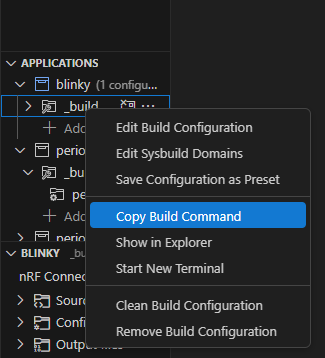

    To see what paths that are in your build command, you can copy the build command by right clicking one of the build folders in the "Applications" section in the VS Code extension:
    So if you want to remove some of the paths, unfortunately, you need to remove them from the workspace. I imagine that this is a bit cumbersome, if you are jumping between projects, which is unfortunate.
    You could start removing the board files from the application, and collect them elsewhere, and add this using the extension settings, as in the first screenshot. Ideally, you should only have one version of your board files, and use .overlay files to tweak the behavior between different applications.
