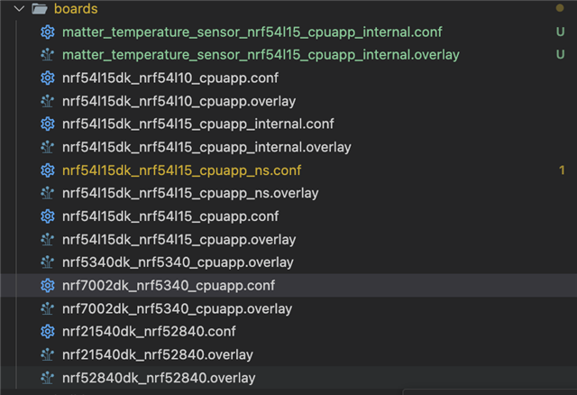

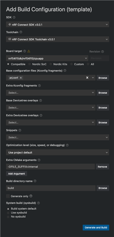

I am attempting to build the Matter template using only the nRF54L15’s internal memory. While the build occasionally succeeds, it more often fails, and I am unsure which build options I have misconfigured. Could you please help me identify and correct the erroneous settings?
Here are the build settings:

Partition 'settings_storage' is not included in the dynamic resolving since it is statically defined.
-- Configuring done
-- Generating done
-- Build files have been written to: /opt/nordic/ncs/v3.0.1/nrf/samples/matter/template/build

    The file boards/nrf54l15dk_nrf54l15_cpuapp_internal.conf' is not included in your build log. It should be included after prj.conf, like this:
    Loaded configuration '/home/marte/ncs/zephyr/boards/nordic/nrf54l15dk/nrf54l15dk_nrf54l15_cpuapp_defconfig'
    Merged configuration '/home/marte/ncs/nrf/samples/matter/template/sysbuild/mcuboot/prj.conf'
    Merged configuration '/home/marte/ncs/nrf/samples/matter/template/sysbuild/mcuboot/boards/nrf54l15dk_nrf54l15_cpuapp_internal.conf'
    Merged configuration '/home/marte/ncs/nrf/samples/matter/template/build/mcuboot/zephyr/.config.sysbuild'
    But in your case, this file is skipped:
    Loaded configuration '/opt/nordic/ncs/v3.0.1/zephyr/boards/nordic/nrf54l15dk/nrf54l15dk_nrf54l15_cpuapp_defconfig'
    Merged configuration '/opt/nordic/ncs/v3.0.1/nrf/samples/matter/template/prj.conf'
    Merged configuration '/opt/nordic/ncs/v3.0.1/nrf/samples/matter/template/build/template/zephyr/.config.sysbuild'
    Configuration saved to '/opt/nordic/ncs/v3.0.1/nrf/samples/matter/template/build/template/zephyr/.config'
    It should have been included when you built with -DFILE_SUFFIX=internal, but I do not know why it is not in this case. Can you verify that the file exists in your project?
