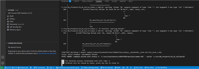

I followed the instructions in Lesson 9, Exercise 5 of the FOAT course. However, I am unable to complete the build process. I was wondering if I might have missed a step or made a mistake during the setup.

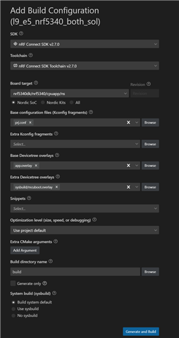

Could you please help me identify what might be causing the issue? I would be happy to share the error messages or logs if needed. I attached the error and the Build configuration below.
Thank you in advance!

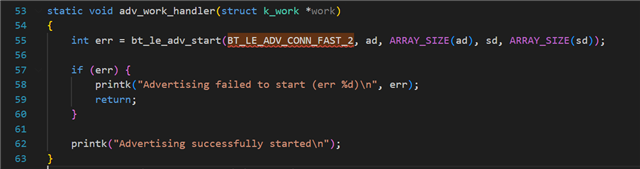

'BT_LE_ADV_CONN_FAST_2' undeclared (first use in this function); did you mean 'BT_LE_ADV_CONN_NAME_AD'?

    The problem is actually the highlighted part in the main.c file. I replaced it with "BT_LE_ADV_CONN_NAME" then it had a successful build.
