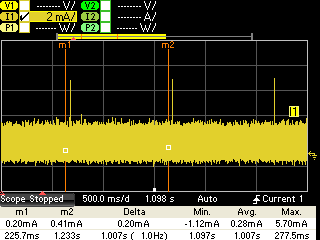

I am working with the nRF54L15-DK and testing the Bluetooth Direct Advertising sample application (based on Zephyr). I am measuring current consumption using a DC Power Analyzer.
Observation:

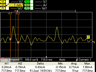

During BLE advertising at a 1000 ms interval, I observe unexpected periodic current spikes between the advertising events.
Spike Details:
  • Peak Current: ~1.98 mA
  • Duration: ~51.2 µs
  • Average: ~0.71 mA
  • Interval: Occurs consistently between each advertising event
Expectation:
From the code and system behavior, it appears that the device should be entering sleep mode between advertising intervals. Therefore, I was expecting minimal background activity and a flat low-current line during the advertising gap.

Attached the scope images:
  • Periodic Current spike
  • 1s interval current

    The spikes I see at 1 Hz is expected given that that is the advertising interval, so the spikes are expected.
    Is it related to any background system task, RAM retention, clock calibration, or BLE stack behavior?
    I assuem the problem here is the high idle current (the current consumtpion between the spikes caused by advertising)? This looks like more ocnstant curernt consuption (though you wil see high frequency spikes due to DC/DC operation).
    How can we suppress or eliminate these spikes to optimize current between advertising events?
    Disable any peripherals or resources that is not needed durign sleep, paritcularily any that requier the high frequech clock, such as UART or other serial interraces. There are some typicall reason for high current consumption, and often it is caused by UART logging. Do you have UART enabled? If so, you should disable it. See Power optimization recommendations. If that does not help, we need to look a bit further, and would need more information about your application.

    • The spike in 1Hz is expected, That is advertising spikes. However we are worried about the spikes (~2mA) in between the adv interval. The first plot which i shared in the first post is the zoomed-in view of the spikes of in between the adv interval.

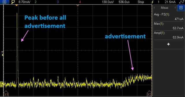

    • However after this configuration we got a big spike (~30mA) before the all advertisement. Please find the scope image below.
      This spike occurs before all advertisement. Is it because of wakeup from the sleep? If not how to eliminate it?
    That looks like CPU processing. It looks higher than I woudl have expectedx, but that could be due to measurment setup or configuration. Can you try to get a better plot showing more details of it?

    Yes, I expect so. The pattern matches expected CPU processing, starting HFXO etc, when the device wakes up for the BLE event.
    This is the oscilloscope image for better view.
    Measurement setup
    using keysight current probe for the measurement. Connected to P6 of nRF54L15DK. Disabled UART and Debug interface using board configurator.
    There is no application modification rather the i mentioned in the previous post.

    The peak looks higher than I would have expected, but it depends on several factors and measurement setup. I am not able to see from the image, but it may be very short in time so that the total energy is what you would expect.
