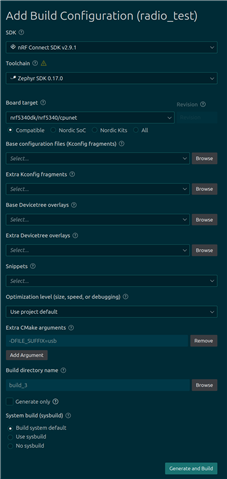

    Sorry for missing this in my initial post. There's a configuration suffix that you can apply to enable USB:
    FILE_SUFFIX=usb
    Which is appended like this when building in VSCode:
    For command line build:
    west build -b nrf5340dk/nrf5340/cpunet -- -DFILE_SUFFIX=usb
    Could you try this and see if this helps?
