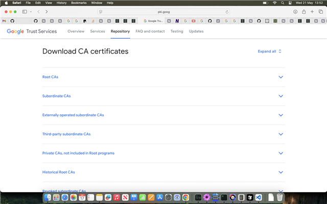

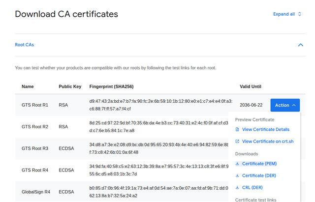

    You need to download r1.pem from here: https://pki.goog/repository/
    Place this in certs/ folder, and make sure that you change the file in CMakeLists.txt, change the domain in kconfig, and add the required configurations in the board .conf file:

  • There are many options and suboptions in the link you sent me. Which one is the correct one?
    When attempting to get it working, I got r1.der and then created r1.der.inc. But I'm not sure which option I chose.
