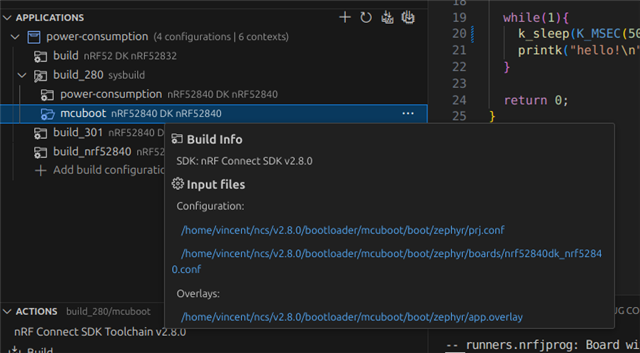

-> Go for mcuboot and look at the default path, they are absolute !

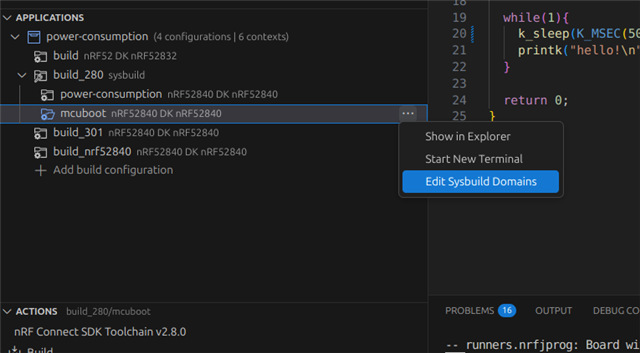

-> Go to edit sysbuild domain

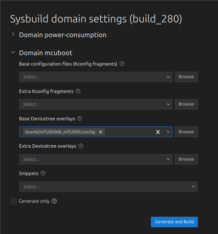

-> Add an overlay

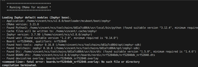

-> Look the command with relative path instead of absolute
-> And the "no such file or directory error"

   * Running CMake for mcuboot *
-- Application: /home/vincent/ncs/v2.8.0/bootloader/mcuboot/boot/zephyr
-- CMake version: 3.21.0
-- Found Python3: /home/vincent/ncs/toolchains/b81a7cd864/usr/local/bin/python (found suitable version "3.12.4", minimum required is "3.8") found components: Interpreter
-- Cache files will be written to: /home/vincent/.cache/zephyr
-- Zephyr version: 3.7.99 (/home/vincent/ncs/v2.8.0/zephyr)
-- Board: nrf52840dk, qualifiers: nrf52840
-- Found host-tools: zephyr 0.16.8 (/home/vincent/ncs/toolchains/b81a7cd864/opt/zephyr-sdk)
-- Found toolchain: zephyr 0.16.8 (/home/vincent/ncs/toolchains/b81a7cd864/opt/zephyr-sdk)
-- Found Dtc: /home/vincent/ncs/toolchains/b81a7cd864/usr/bin/dtc (found suitable version "1.5.0", minimum required is "1.4.6")
-- Found BOARD.dts: /home/vincent/ncs/v2.8.0/zephyr/boards/nordic/nrf52840dk/nrf52840dk_nrf52840.dts
-- Found devicetree overlay: boards/nrf52840dk_nrf52840.overlay
<command-line>: fatal error: boards/nrf52840dk_nrf52840.overlay: No such file or directory
compilation terminated.
