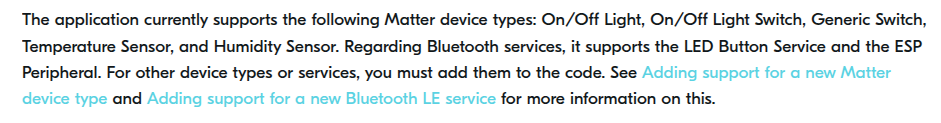

    The application currently supports the following Matter device types: On/Off Light, On/Off Light Switch, Generic Switch, Temperature Sensor, and Humidity Sensor. Regarding Bluetooth services, it supports the LED Button Service and the ESP Peripheral. For other device types or services, you must add them to the code. See Adding support for a new Matter device type and Adding support for a new Bluetooth LE service for more information on this.
