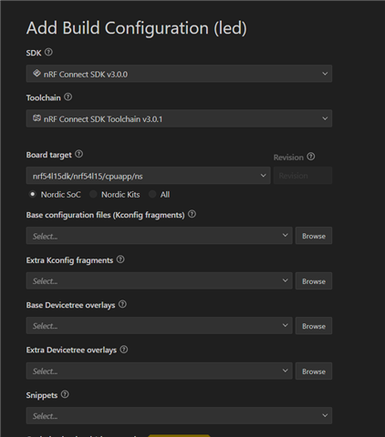

  • HI.
    Delete your build folder, re-generate the static library, and ensure that both the application and the lib has CONFIG_FPU set.
    I deleted not only the build configuration but also the build folder, and re-made.
    Now prj.conf is written below.
    CONFIG_LOG=n
    CONFIG_NRFX_GRTC=y
    #CONFIG_NRFX_SAADC=y
    CONFIG_NRFX_TIMER22=y
    CONFIG_GPIO=y
    CONFIG_I2C=y
    CONFIG_COMPILER_OPT="-DARM_TABLE_TWIDDLECOEF_F32_64 -DARM_TABLE_BITREVIDX_FLT_64 -DARM_TABLE_TWIDDLECOEF_F32_64 -DARM_TABLE_TWIDDLECOEF_RFFT_F32_128 -DARM_MATH_CM4"
    CONFIG_CMSIS_DSP=y
    CONFIG_DSP=y
    CONFIG_CMSIS_DSP_FASTMATH=y
    CONFIG_CMSIS_DSP_STATISTICS=y
    CONFIG_FPU=y
    CONFIG_PM_DEVICE=y
    CONFIG_POWEROFF=y
    But I failed to build.
    This library(.a) uses Application Binary Interface(ABI) setting with "mfloat-abi=hard".
    Target processor: Arm Cortex-M4F or upper. Floating point unit needed.
    Operation checked with nRF52840.
    Necessary library: CMSIS-DSP
    Best regards.

    And, I confirmed
    CONFIG_FPU_SHARING=y
    in .config output. I'll put this.
