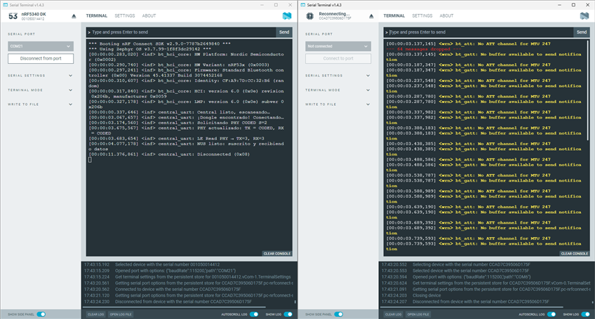

    When I try increasing the packet size to 244 bytes and reducing the interval to 50 ms, the system gets overwhelmed and starts failing — you can see the issue in this screenshot:
    My goal is to test all four PHY configurations (1M, 2M, CODED S=2, and CODED S=8) under the same conditions and observe how they affect RSSI and bitrate. But I'm not sure how to force or verify the use of S=2 vs S=8, or how to properly configure the system so it can handle higher data rates without dropping packets.
    Any help or advice would be greatly appreciated, especially regarding how to properly stress-test the link and measure real PHY performance in Zephyr with the NUS service.
