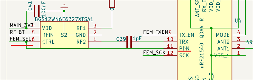

Hi community,
I have a similar custom board as Thingy53, which has the nrf21540 module on board.
my purpose is to turn on the nrf21540 and do the reconnection, when the connection via normal way is lost.
these are the meaningful rescources I can find, but still cannot make the nrf21540 on my board working.

    Your forwarder setup is not correct for enabling the nRF21540 FEM in the cpuapp dts overlay file. You have to enable this by changing status = "disabled"; to status = "okay"; in your gpio_fwd node.
  • Hi
    thanks!
    after enabling both "status" for gpio_fwd and spi_fwd, the nRF21540 module is working.
    my purpose is to dynamically switch the short and long range antenna depending on the bluetooth signal strength, is it possible to achivce this?
    or at least, first turn on the short range antenna, if it's disconnected, then turn on the long range antenna by pulling up the PDN pin of nRF21540.

  • Hello Danny,
    It is possible to switch antenna by ANT-SEL pin but there is no built in BLE stack support for dynamic antenna diversity. The switching can only occur between packets not during packet reception. You can read this case (+) nRF21540 antenna diversity for BLE - Nordic Q&A - Nordic DevZone - Nordic DevZone.
    If you need to dynamically switch antennas based on signal strength, you can control the relevant GPIOs (such as ANT_SEL or PDN) from the network core, you have to set up forwarding and device tree configuration correctly.
    you should add the ant-sel-gpios property to your FEM node in the network core (cpunet) devicetree, and ensure the corresponding pin is forwarded from the application core (cpuapp) using the gpio_fwd node.

  • Hi
    thanks for the reply.
    what I want is the dynamic switch between direct antenna from nRF5340 and FEM antenna from ANT1 of nRf21540. seems not possible.
