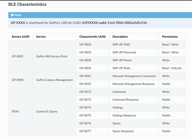

I'm trying to control a GoPro camera via ble. Gopro has documentation that describes the available services and chars, as well as the exchange protocol (https://gopro.github.io/OpenGoPro/ble/).
At the moment I am trying to send a command to the camera and get a response from it. I need to write the command in the characteristic 0x0072 of the service 0xFEA6, and get the response in the notification of the characteristic 0x0073.
I used the ble-nus-c example (for central device) and modified it a little. I posted the full code on GitHub https://github.com/Sergey1560/nrf52_gopro/tree/master
If I understand correctly, in my case, service 0xFEA6 is type 1 (BLE_UUID_TYPE_BLE), and the characteristics of this are type 2 (BLE_UUID_TYPE_VENDOR_BEGIN).

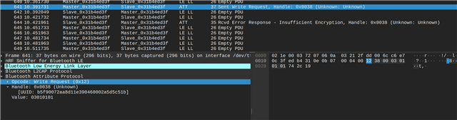

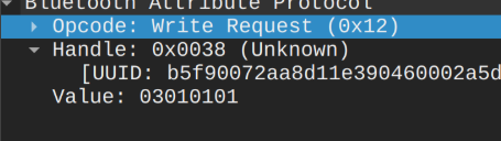

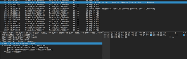

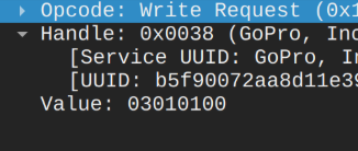

I used a sniffer to see what is happening and compare the command that I send from the phone via nRF Connect and from my code.
From nRF Connect:
From my code:
The difference is that when writing from my code, service 0xFEA6 is not specified in Handle 0x38, only UUID . That's why I get an error reply from camera.
What am I doing wrong, why is the service not specified when writing?
