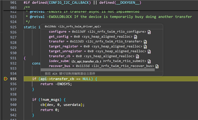

  • Hi!
       me too;
       NCS 3.4.0  nrf52840DK
     i2c_transfer_cb_dt()  point NULL

    api->transfer_cb == NULL!!!
     could you help me!
