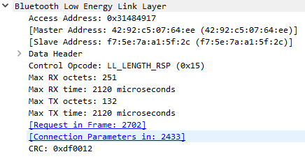

When other Bluetooth devices send LL LENGTH RSQ, NRF will only take a minimum value to reply with the same RX TX.
This is also verified in wireshark.
But, I can still manually set an unsymmetric parameter and reply via sd_ble_gap_data_length_update.

err_code = sd_ble_gap_data_length_update(conn_handle,&params,NULL);
It also can works and verified in wireshark.
So I'm wondering if it's a wrong behavior that I manually reply the unsymmetric parameters?
Does it take effect inside the Bluetooth stack? Does the data transfer really follow this unsymmetric parameter?

    The challenge I’m facing is that the third-party app I need to support sends an LL-length update with different RX and TX values (e.g. RX = 251 bytes, TX = 27 bytes). If I let the SDK handle the request automatically, it forces both directions down to 27 bytes, its unacceptable.

    Sorry for the delayed response. The latest nRF5 SDK releases included an option named NRF_BLE_GATT_MTU_EXCHANGE_INITIATION_ENABLED, which allowed you to disable automatic MTU exchange initiation. I'm not sure which SDK version you're using, but could you try not initiating the MTU exchange yourself and instead let the phone handle it to see if that prevents the phone from selecting asymmetric data lengths?

    Thanks for confirming. So it seems to be a timing problem. That is, the particular phone(s) you are testing with don't like that the MTU exchange is initiated immediately from the connection callback. I think a workaround would be if you could delay the MTU initiation. For example, if the phone does not initate the MTU exchange, wait x seconds and call sd_ble_gattc_exchange_mtu_request() in your app.

    Thank you for your response—everything’s working great now! I’m actually using SDK 15.3, which doesn’t include the NRF_BLE_GATT_MTU_EXCHANGE_INITIATION_ENABLED macro. I checked SDK 17.1 to confirm its scope, then commented out that section in gatt.c to simulate the macro’s behavior. In main(), I set up a 500 ms timer so that, when acting as a peripheral, it triggers the MTU exchange 500 ms after BLE_GAP_EVT_CONNECTED. The code runs perfectly, and the phone no longer repeatedly requests an asymmetric LL LENGTH (I suspect the previous MTU exchange wasn’t actually effective).
