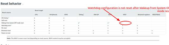

problem with NFC handling
I'm using the nRF52832 with SDK version 17.0.1.
I've noticed that when the device wakes up from NFC and remains in proximity to the NFC field, it sometimes experiences a watchdog reset.
Could you help identify what might be causing this issue?
Is it possible that we're not handling the NFC interrupt correctly?
