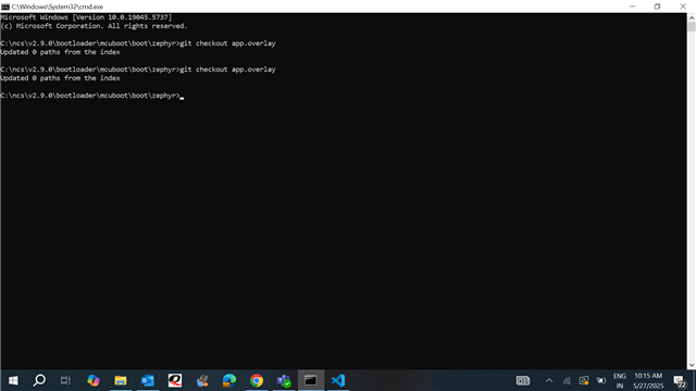

    It looks like you have altered the mcuboot app.overlay file:
    -- Found devicetree overlay: C:/ncs/v2.9.0/bootloader/mcuboot/boot/zephyr/app.overlay
    devicetree error: 'pinctrl-0' is marked as required in 'properties:' in C:/ncs/v2.9.0/zephyr/dts/bindings\i2c\nordic,nrf-twim.yaml, but does not appear in <Node /soc/peripheral@50000000/i2c@c6000 in 'C:/ncs/v2.9.0/zephyr/misc/empty_file.c'>
    CMake Error at C:/ncs/v2.9.0/zephyr/cmake/modules/dts.cmake:295 (execute_process):
      execute_process failed command indexes:
    I would recommend that you revert the changes done in this file:
    Go to folder "C:/ncs/v2.9.0/bootloader/mcuboot/boot/zephyr/" and open a cmd line in this path, then write:
    git checkout app.overlay
    Håkon
    I tried this, but I still get the same error while compiling for nrf54l10.

    And how does your .overlay file look now?
    It seems that you're lacking the pinctrl-1 entry, based on the error message.
    Håkon
    Yes, the pinctrl-1 entry was missing; adding it successfully compiled my code.
    Thanks for the help.
