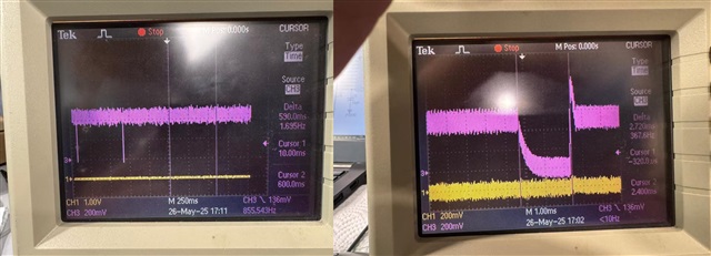

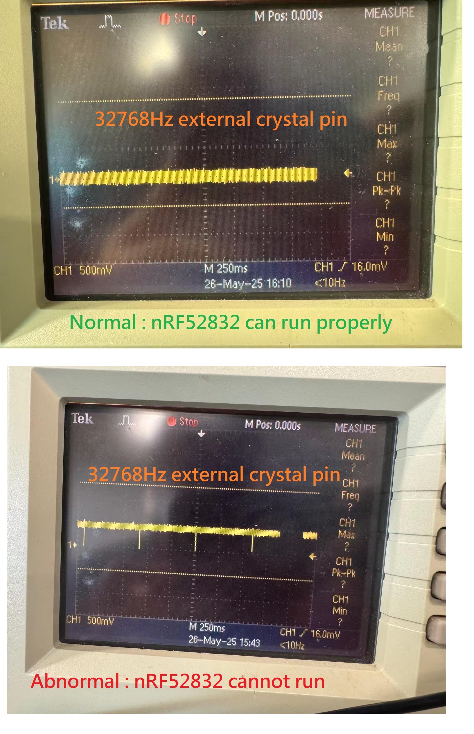

We measure the external 32768Hz crystal pin and find a glitch to GND periodically. (once every 590ms)
For a good module, there is no such glitch in the crystal oscillation.

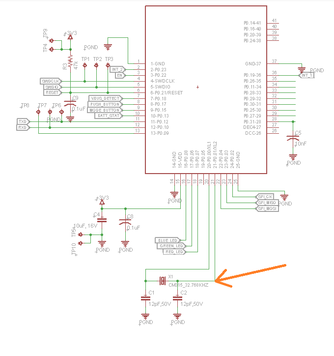

Please refer to the attached picture and the schematic.
The crystal is good if we swap the 32768Hz crystal with another good PCBA.
Is there any reason why there is a glitch to GND periodically?? We guess this glitch led to the BLE module not operating.

  • Hi Asbjørn,
    1. Only XL2 that drops to 0V (XL1 is no problem)
    2. The drop is not charging across time and I don't know whether there is FW halts. But it seems no a few times occurrence.
    3. I don't know whether the chip is reset or not. But the reset pin is stable without change.
    4. The VCC voltage is measured, and it looks stable over time.
    We are still looking into it and see if the reply above can help further analysis.
    And one more picture of the waveform of XL1 and XL2 pins is attached for your information.
