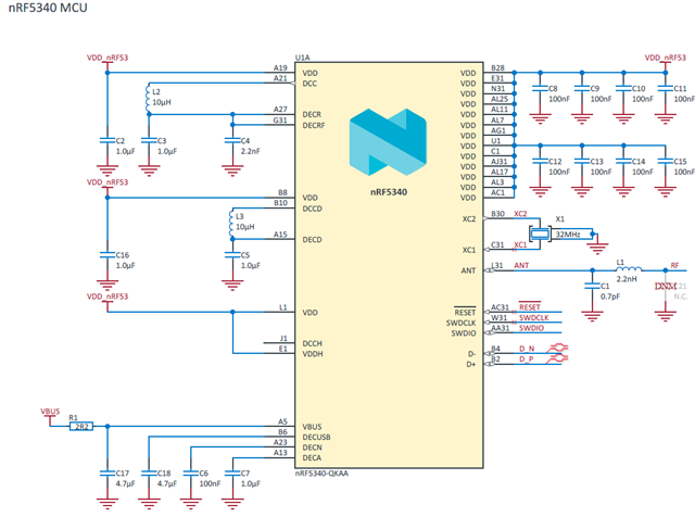

Hi
Could you provide what is the max DCR value of L2/L3 10uH inductor in document "PCA20053_Schematic_And_PCB.pdf" that nRF5340 can be accepted?
nRF5340 datasheet only show Isat>90mA requirement
Could you help check if TAIYO/LSQPB160807T100M can be used for nRF5340 L2/L3 10uH inductor?
Thank you
Poki
