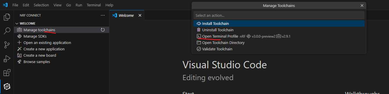

  • Kashyap23 said:
    r.I am using sdk v2.9 and toolchain v2.8
    Please make sure to always match the SDK and toolchain versions and make sure that you're building the audio application from the SDK version you're using.
    If you need input with the basics of NCS, building and seeing how things works together, I strongly recommend you spend some time in our academy pages
    https://academy.nordicsemi.com/courses/nrf-connect-sdk-fundamentals/ and https://academy.nordicsemi.com/courses/nrf-connect-sdk-intermediate/
    Andreas
  • I have removed the existing builds and i ran the script ,it worked now.
