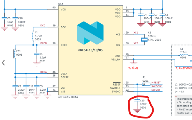

nRF54Lxx - reset circuitry
Dear all,
I am wondering, what is the reason for C13 being 3.9pF for QFN package, while there is no capacitor on WLCSP reference design? Could we use like 10nF instead? From what I see, this is a part of low-pass filter for RESET line from external circuitry (programmer).
Typical reset circuit on microcontroller is 10k pull-up + 10 or 100nF to GND, but there is no recommendation for that. Obviously, there is some other reason behind selected value.
Many thanks for your answer.
