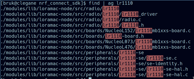

Hi Andy,
there is no driver code there
I can see driver code for my SDK install:
Maybe something went wrong in the installation?
Try to run "west update" again, and check the folder again.
Sigurd Hellesvik
Sigurd
I have the same set of files - see below screenshot

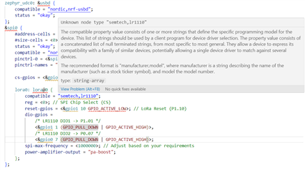

The problem is that I cannot select "semtech,lr1110" in the "compatible" section when I define the lora0 dts node
The following semtech devices can be selected: sx1272,sx1261,sx1276 but there is no lr1110
How do I get around that?

When you say "cannot be selected", can you share the build logs with the error saying this?
Sorry didn't make myself clear
This is what I'm referring to
Here are the errors I get in the bulid
